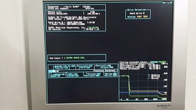

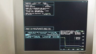

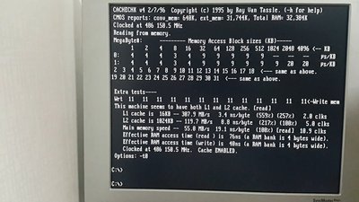

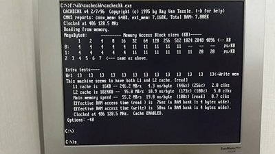

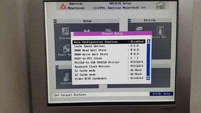

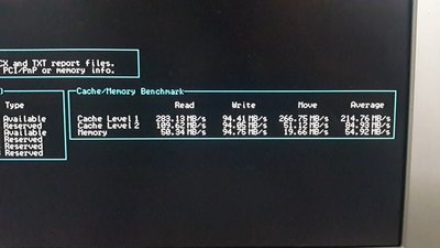

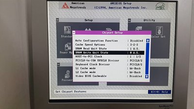

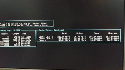

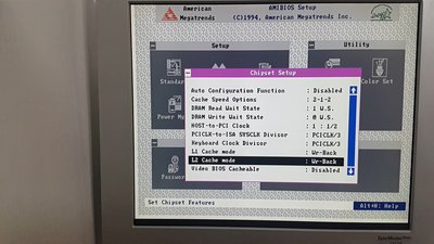

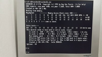

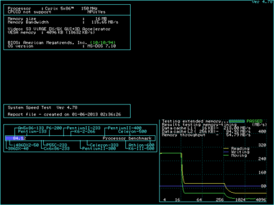

i upload 3 cachechk,speedsys result of Cyrix 5x86 cpu
5x86 120MHz (FSB 40x3)
5x86 120MHz (FSB 60x2)
5x86 150Mhz (FSB 50x2)
this is 40MHz's result (120MHz, FSB40 x 3)
120MHz FSB40 cachechk&speedsys youtube link : https://youtu.be/xzim9hUUHn8
120MHz FSB60 cachechk&speedsys youtube link : https://youtu.be/7HV8h9e8Rvg
150MHz FSB50 cachechk link : https://youtu.be/H7okt__2DFk
150MHz FSB50 speedsys link : https://youtu.be/EUj0pMceRw8
i seperate 150MHz's cachechk,speedsys result because 32MB ram consume many times in cachechk.

Reply 1 of 6, by skv400
this is fsb60's result. (120Mhz, 60x2)

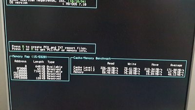

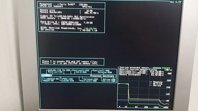

Reply 2 of 6, by skv400
This is 50MHz's result (150MHz, FSB50 x 3)

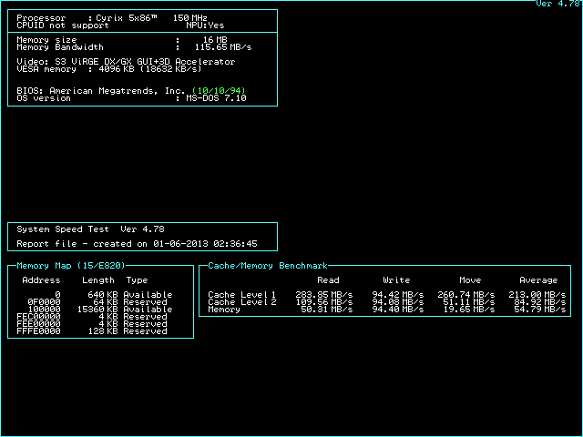

Reply 3 of 6, by feipoa
Attached are my IBM 5x86c-150 results. Were you able to load Windows? What about run the Quake timedemo? What motherboard are you using?
12.44 KiB
366 views
9.92 KiB
366 views
Reply 4 of 6, by meljor
Wow! Feipoa, that's exactly TWICE the score of my amd dx4 120mhz! How can it be THAT fast?
A few hours ago i received my 5x86 amd 133mhz and my cyrix 100gp. I will test them within the next few hours but the results won't be anywere near yours, that's for sure 🤣
Is that win95 stable??
Reply 5 of 6, by feipoa
It ran DOS well, not Windows. After a few hours of abuse, that particular chip died. I had chips to burn, so it was not much of a loss. That screenshot is from several years ago.
Reply 6 of 6, by skv400
i don't try install windows.
but unstable. can't run quake long time. can run short time(maybe 30sec)
