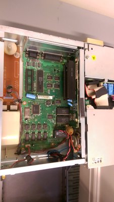

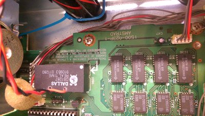

So I managed to finally pop the hood on this thing and take a peek inside.
First off, JidaiGeki was correct - the internal clock is a Dallas chip. But I was delighted too discover it appears to have been already modded to draw power from two AAs, so getting the clock to work again should be a snap! 😁
Here's some photos so you can all appreciate some 1980s Amstrad goodness. Would appreciate some help in identifying what chips appear in these photos. I love learning about them.
    1.22 MiB
    1185 views
    Main board

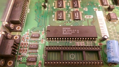

Reply 16 of 22, by gladders
What's this Siemens chip? And next to it is what appears to be an empty socket - what could be put there?
Ah, the Siemens is the 8Mhz 8086 Intel CPU.
And the big blue barrel at the bottom has what looks like glue on it - is that normal?

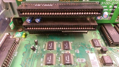

Reply 17 of 22, by gladders

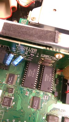

ISA slots seem in good condition if a little dusty. What are those chips on the board?
Also it looks like the cap at C50 is in a bad way...
