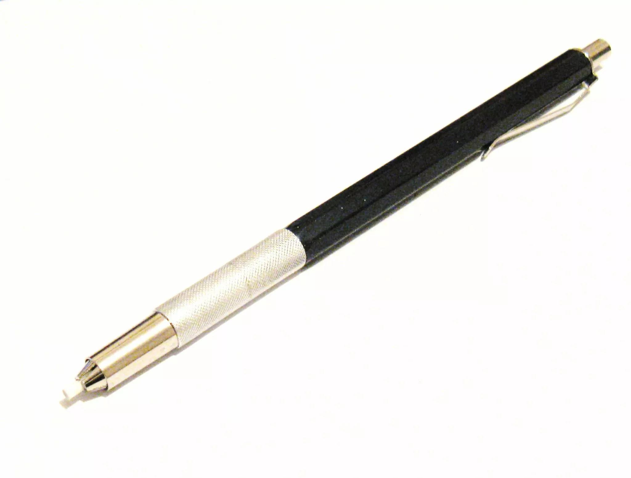

A couple of tips for the future. Single strand ethernet cables for fixed installation (as opposed to multi strand patch cables) are a good source of wire for that kind of repair jobs. A fibre glass brush makes solder mask removal a piece of cake
