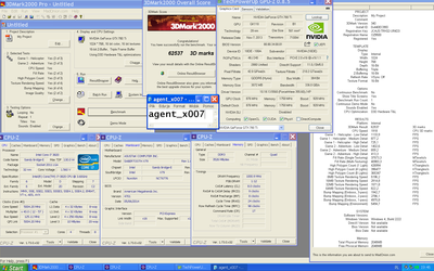

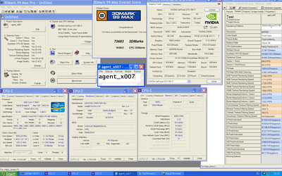

Reply 1 of 241, by agent_x007
Don't know your budget... BUT GTX 780 Ti is really good 😀
3DMark 99 :
247.15 KiB
10544 views
3DMark2000 :
254.62 KiB
10544 views

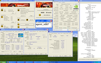

3DMark01 :
662.94 KiB
10544 views

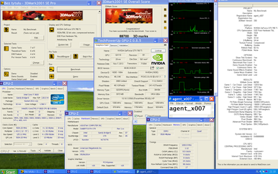

3DMark01 SE :
523.37 KiB
10544 views
No problems so far 😀
