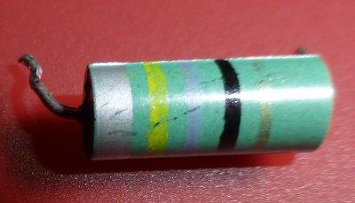

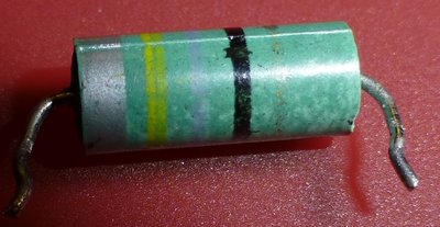

After fixing an old EGA card by replacing a dead tantalum capacitor, it gave me renewed hope of fixing this keyboard.
So, I found a resistor on my keyboard's PCB that was showing as shorted when using my DMM's continuity tester. I desoldered it to test it out of circuit and it still shows as being shorted. When testing the resistance it shows 2.5 ohms. The problem is, the color code on this old resistor is a bit hard to make sense of... and anything I come up with is nowhere near 2.5 ohms.
My best guess is 47ohm (ignoring the silver end)...
529.81 KiB
1514 views
465.26 KiB
1514 views
... but I have no idea if this is right. Whatever it is, it can't be 2.5 ohms... so I want to make sure I get the correct value and replace it, just in case this is the problem.
If it helps any, it is visible in the pictures here too:
https://goo.gl/photos/vcKsPKahqoWmGRjC9
Also... in the above pictures, what is the large red cylindrical part on the board (it is labeled 492 402)? That seems to have an extremely extremely high resistance and is showing no continuity at all.
