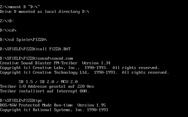

Is it or will it be possible to emulate the Soundblaster 2.0?? I have an old game that only plays sound with SB 1.5, 2.0 and MCV 2.0 (whatever that means).
Reply 4 of 43, by eTaurus
I had a question concerning SB 2.0 and when Qbix tells me that DOSbox emulates it as default it is ok. But if you are really interested in my problem: Pizza Connection is the name of the game. It only accepts SB 1.5, 2.0 and MCV 2.0.

But back to the problem: The game has no setup, where you can choose a soundcard. After starting it one can read that it only accepts the cards mentioned above and that it is preconfigured at 220 Hex and Interupt 80H. I have no idea what that means but probably it helps you to solve my problem. In my old DOS machine I had to set the jumpers according to these values to get sound.

Reply 11 of 43, by eTaurus
I get exactly the same screen. I searched the directories and I only found
"pizza.bat" which executes "sound.com" and then "pc.exe". "pc.exe" starts the game. Moreover there are "hiscores.exe" and "dos4gw.exe". There are no more executable files. There is only one more file with a known ending and that is "sound.drv". I always found it quite unusual to write a game without setup.
Ooops, not really exactly. It is partly in german but the crucial things are clear I think. By the way: I use the "d-fend" frontend.

Here a short description of the problem:
Name of the game: Pizza Connection (europe version, I don't mean Pizza tycoon)
The installation is no problem, the game is running fine on dosbox. But there is no sound. And I wanna know why.
The screen posted by eTaurus is still the same as it was in 2004. The game says:
driver I/O adress 220 HEX
driver installed on Interrupt 80H
But the sound is not playing. There is no soundconfiguration where you can configure the parameters but it is nessesary to run the sound.com before starting the game.

The readme says that the first entries in config.sys are for low level drivers which are needed for old games. I think this old game pizza connection install the drivers directly before starting it. For example i get an error in the virtual box if no sounddrivers are installed and
SET BLASTER:A220 I7 D1
entry is missing in autoexec.bat, so the Blaster settings must be set in autoexec.bat and then sound.com can find all settings for itself and install the driver.
Is it possible, that dosbox don't understand this self installed driver and force the emulation drivers to work? Or is it possible, that in this emulation the emulated driver from dosbox can't handle an self installed driver of sound.com?
As i said before, sorry for pushing such an old thread, but I've been searching for a solution to play this game for about half a year. I tested Windows Virtual PC (that comes wih no integration features for dos now), VirtualBox and i will test VMWare Workstation in the next few days, but DosBox would be the best solution. We only have to find the problem why DosBox don't play sound.
Thanks for your help
Gubbl
Edit:
In fact there is no error in installing the driver with the sound.com. When i try to execute sound.com a second time it says: driver installed insteas of driver installed at interrupt 80H. So the problem is not an error in installing the driver.
