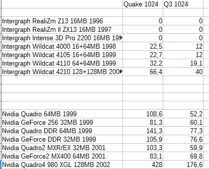

Btw many profi cards supports only Win NT/2000/XP and mostly only OpenGL - so forget directx games (nvidia, some 3dlabs can do) and you have to stick with GLQuake and similar.... Also these cards are not soo good in games like more common gaming cards...See atachment for quick review of mine tests on MSI board with dual Athlon MP2400+. Now im benching them again with Tyan board, because MSI is incompatible with everything from 3Dlabs. If youre into real highend workstation stuff, you should get rather dual Slot Xeons 😎 Seen those years ago in refubrished Intergraph workstation mine coworker bought home for his mother internet use 🤣 (was cheap back then - got one of mine intergraph graphic card from him).
