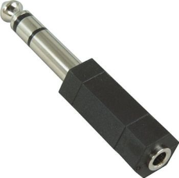

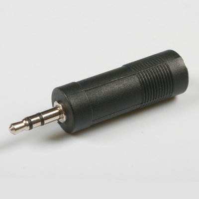

Reply 7 of 19, by jesolo
Ok, I tried something ridiculous and used the following two adapters:
8.5 KiB
1121 views
6.5 mm to 3.5 mm adapter
3-5mm-Male-plug-To-6-5mm-Female-jack-Converter-Stereo-Headphone-Microphone-Mic-Adapter.jpg
116.42 KiB
1121 views
3.5 mm to 6mm adapter
I then plugged my headphone jack into the back of the 6.5 mm to 3.5 mm adapter and now I get sound output from both speakers.

Reply 9 of 19, by jesolo
No, that doesn't seem to work.
Coming back to my previous post, I'm getting mixed results. Sometimes I get output on both channels and other times I just get output on the right channel.
Since the sound card outputs a mono signal, shouldn't I rather use a converter (adaptor) that has a mono input (one ring) that goes into the Speaker Output?
In other words, a 3.5 mm mono input to a 3.5 mm output adaptor? Should the output be mono or stereo?
Could be that I just have the wrong type of 3.5 mm stereo connectors?
