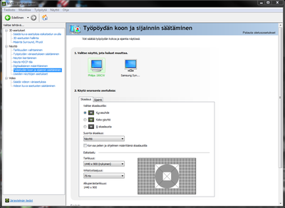

Reply 8 of 17, by Aideka
I have a display connected via VGA and I still have the scaling options on Nvidia control panel. I have a GTX 750 Ti graphichcard though, but I would be willing to bet that the driver you have does hae the scaling option too. I will attach a screenshot of where to find the option, sadly the screen is in Finnish, since I cannot seem to change the language, but you should still find it. I think the menu in english is "Desktop size and position", that Philips 190CW monitor you see on the screenshot is the one plugged in via VGA

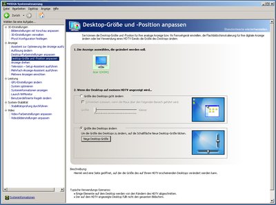

Reply 9 of 17, by Roman78
Thanks for the picture. I just put the text into Google translate an d it should be this option, but mine is different. See picture. Strange thing is when i change the resolution in windows itself or whit the Nvidia tool i get black borders on both sides. But than when i start a game it's gone.
Edit: i updated to the latest driver and it is still the same, only nTune is not working anymore, but i did not suppose to OC.

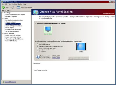

Reply 11 of 17, by Aideka
Hmm, found a tip on other forums, that if you lower the desktop resolution of your computer to something lower than the standard resolution is, it might show the scaling options after that. Also, I think your monitor is being detected as a TV for some reason, it might be the reason why the option to scale isn't there.
EDIT: Maybe on to something here http://forums.anandtech.com/showthread.php?t=2116350&page=2 has a tip on how to get it working
Registered here to post because I figured out a solution. Had this same problem - my monitor was running on a HD 1080p TV resolu […]
Registered here to post because I figured out a solution. Had this same problem - my monitor was running on a HD 1080p TV resolution instead of a PC resolution according to Nvidia.
Try this in the Nvidia control panel:
1. Go to Display > Change Resolution
2. Click on Customize
3. Create a new resolution matching your native resolution (1920x1080 for mine)
4. Test it, if it's successful, keep the change. Nvidia should now recognize your display as a PC monitor, rather than a TV.
I was then able to change my scaling options for it, which resulted in no stretching for 4:3 resolution games. Hope this helps.
