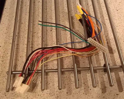

I have succesfully used an old Codegen 300watt PSU from 2003/04 too. Without any issues at all.
There are these:
http://www.ebay.com/itm/20P-ATX-to-2-Port-6Pi … VEAAOSwNSxVX3Xf
That have -5V line (white line are visible)
Or you can build your own like I did, were I used more rail-lines from the ATX psu, than are used on the "China-Converter".

Reply 5 of 7, by markot
Is there any place on ebay (or somewhere else) where I could buy these P8/P9 connectors and make own ATX-AT adapter cables? I would also like to have the -5 volt available, but how is this done? Is there any schematic?
Reply 6 of 7, by Jepael
Usually -5V is made from -12V, with a 7905 type linear regulator. It just needs one or two caps on its input and output to keep it stable, and for extra stability, I'd put a resistor between 470 and 1kohm to the -5V output as extra load, because usually the voltage is not stable without some load. There's plenty of pictures of DIY ATX to AT cables with 7905 hacked in.
Reply 7 of 7, by brostenen
That's the thing.... I used two that came off an AT psu. (dead beyond repair)
Early ATX psu's had a P10 connector, that can be used too.
If you have access to two ATX psu's, then use them.
I have found this on eBay. Not the cheapest.
http://www.ebay.com/itm/ATX-Power-Supply-P8-C … 9AAAOSwvg9Xc-fL
