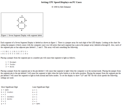

Reply 3 of 3, by Beegle
Someone found this for me on a diy forum when I was building my retro build, and I had trouble with this too. So far this info never failed me. Enjoy!
