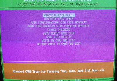

Does your BIOS have an Auto-Detect Hard Drive setting?
See 6th line item on my 486 BIOS screen:
