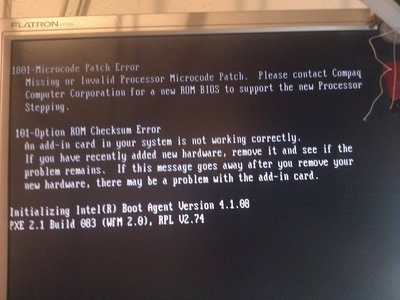

The Unsupported Celeron gives me a Microcode not found error.
But F1 allows to proceed.

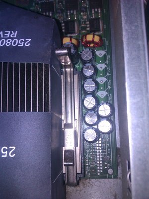

Must be pretty hot inside, the Caps on the CPU Coolerside are partially broken.

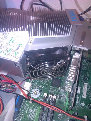

i upgraded it to 1GB SDR and a 6200 512Mb AGP LowProfile, needed to remove the Cooler and add a much smaller one but powersupply fan sucks air over it..
XP runs very well.
Compaqs Support says the latest bios supports northwood 😒
It should also support 3Gb - 3x 1Gb SDR-Ram.
also this thing complains about Checksum of Option ROM are wrong but this is not the case.
i double checked it and reflashed the videobios..
it does not like the 512Mb 6200 GeForce..
Anyway all is working fine, just bypass Errors.

Modified GeForce 6200, Cooler doesnt fit, replaced it with a smaller one.
2.88 MiB

Capacitorbank, near CPU Cooler.
2.43 MiB
450 views
BIOS Errors:
2.59 MiB
449 views

Only the caps near the cpu cooler are affected i desoldered a few other measured them, and they are fine, some are at 150% Capacity and no Vloss at all.
But near the CPU Cooler you can see the electrolyte flowing if you press lightly on the Cap.
i replaced them with hand measured and selected used caps from more modern Stuff which died from other Plagues.
