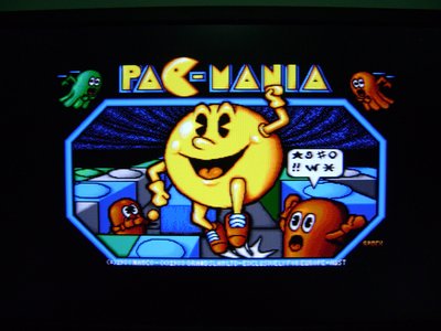

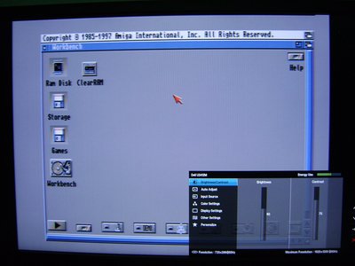

I reckon the Dell U2412M has got to be one of the most Dos compatible monitors around, It does all those weird resolutions like 640x350. It's not perfect for sure and sometimes
it doesn't adjust the resolution properly. In Duke Nukem 2 It was not fitting in the text at the top on occasions, but then at other times it did.
I was just playing around today with my Amiga 500, and have made up a cable to connect to a GBS8200, which works really well, but I thought I would connect it
direct to the monitor and see what happened. It works at 720x288 @ 50hz which is surprising to say the least. It doesn't look too wonderful but would suffice just for games.
The GBS8200 does a better job due to many more adjustments in it's menu. Here's the proof that it works.

The U2412M has settings to force aspect ratio to 16:10 (default, matches display dimensions), 4:3 and 5:4. No setting for 16:9 as far as I know. It does not do it automatically, you have to specify it manually.
The thing about it is that, although it is counter-intuitive at first, it is actually good that the display forces you to set it manually. That is because many DOS games resolutions that were played on 4:3 screens are not 4:3 resolutions. The famous 320x200 is one of them. It is a 16:10 resolution, which means that played on a 4:3 screen it will have non-square pixels. Of course, all games from that time compensate for that, because back then all screens were 4:3. So in order to look right, you have to force the display to 4:3 and not to the real aspect of the resolution. That is why the U2412M in this sense is better than, for instance, my U2410, which has an "Aspect" setting that adjusts automatically.
