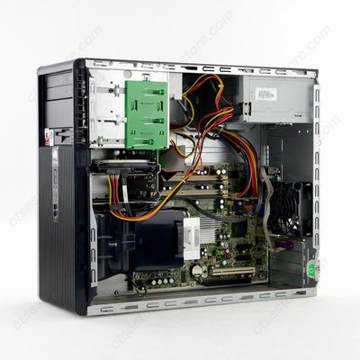

I'm looking at the HP DC5800 CMT as an XP gaming box and trying to decide. I am looking at the Microtower model. It looks to take a standard PSU and the ability to take double slot graphics cards, I will be putting a GTX 285 in it. The top most PCI-e x1 slot will receive a X-Fi Titanium. 4-GB DDR2 800 RAM and a Core 2 Duo e8400 3.0 GHz dual core will finish it off. From my experience quad cores for XP gaming are a waste. What do you think? Anyone used these or have any experience with them?
I like OEM systems, it has a solid metal case and the front audio and USB look to be in a good spot. Parts seem to be easy to find and systems are pretty cheap on ebay.

The problem is that there's a big gap in one PSU "standard" – the positioning of the outlet for the power cord. These cases can be deliberately designed to make it impossible to fit all possible PSUs, probably to entice you to purchase parts from HP. (Last time I needed to replace one, I actually had to loosen the screw next to the outlet so I could just slip the edge of the case a little underneath it.) All I can suggest is that you buy from a store with a good return policy.
The other concern is that it's not a very roomy case and you might have cooling issues with a big double slot graphics card.

I do not foresee any issues with minor sheet metal fitting of PSU, that's why I have a nibbler tool but it looks standard as opposed to some of the later models that have a different shape PSU.
The airflow looks fine to me. Almost the entirety of the front panel looks to be an air intake and the graphics card has plenty of room above it, it is inverted BTX style. Front intake fan for CPU, PSU fan, rear case fan and graphics card (exhausts to rear) keep the air moving. If the BIOS is similar to later models you can change the cooling profile for base fan speed.

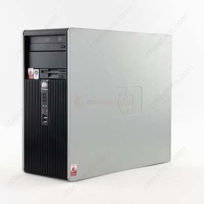

Better Image of case. It is not the same form factor as the DC7800/7900, it is smaller.

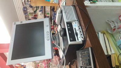

I love business class HP's. They are easy to work on, feature rich, and look good. I just set this one up for a guest pc at work.

Well, it arrived today. It looks in pretty decent shape but they did a poor job packing it and it received a dent in shipment. I'll live... The front panel plastic all looks good though and I think it will cleanup nicely. I like the size of it and the layout looks good.

This may be my favorite OEM system for XP thus far. I really like the layout, the looks and what it has to offer. Front panel audio and USB are in a perfect location, installing a double slot PCIe graphics card and a PCIe sound card still give you one empty slot between the two, thermal design looks good with push/pull air induction (most HP's similar to this use same type design), plenty of room for any size double slot graphics card, and did I mention I like it?
