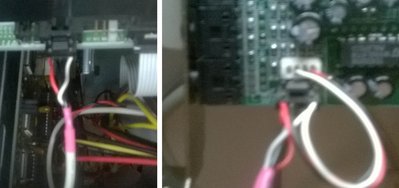

I am unsure of my CD audio connector to the sound card. I might have the wrong cable or the wrong way around.
Here's a picture of the cable and how it's currently connected.

The front jack and that cable that connects CD and sound card are used when the CD is playing CD audio music (i.e.: sound tracks on HOMAM2 and Quake).
The voices in DOTT are digital data stored in a file, that plays through the sound card DAC. The CD is only a storage medium and does not play any voice.
I'd check those digital sound settings, the hardware connections are not involved

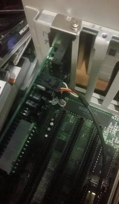

Judging by your picture the CD audio cable at the sound card end is the wrong way around, should be like this:
    55.4 KiB
    578 views
    audician 32 plus cd audio cable

Thanks for that, I have turned it around. Should save me some trouble on games that needs it. What about the little white connector I have attached to it, does it go where I have placed it or is it for something else or not needed?
