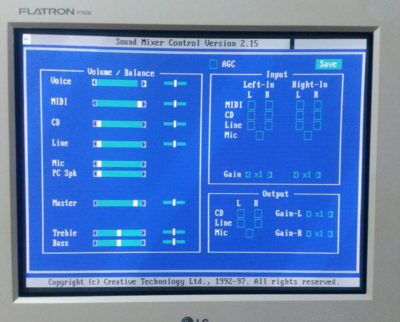

Proper mixer settings would be: everything muted to minimum but Voice, MIDI, Master, Bass, Treble and all X's unticked,.
Voice and MIDI (FM) set to full and Master set one click below full to avoid distortion, Output Gain-L/R set to x1.
These settings produce outstanding SNR with crystal clean distortion-less audio path.

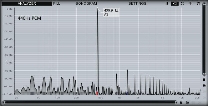

There is no distortion with high volume games, unlike the Vibra16S card I have which distorts no matter what settings in the mixer.

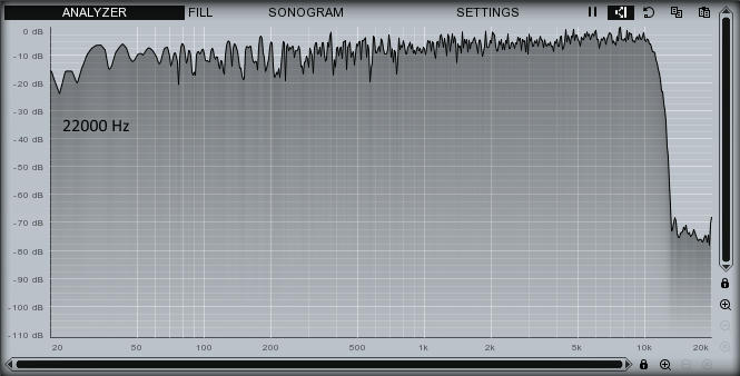

The CT2230 produces exactly the same sound as the CT2950, measured using VST frequency analyzers and accurate VU meters.

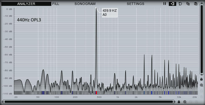

The audio path is very clean and has very low harmonic distortion both in OPL, PCM sound, and Wavetable return.

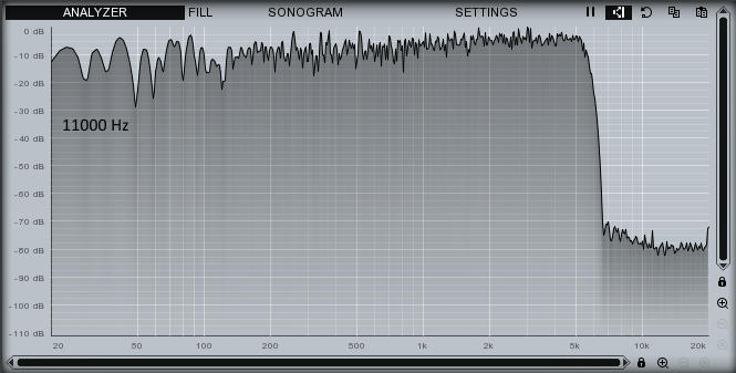

The Dynamic Lowpass Filter which is unique to the SB16 is working and makes low sampling rate games sound good.

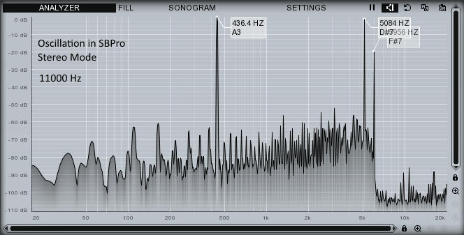

When the CT2230, CT2950, Vibra16S or any other SB16 card (I believe so) is forced into high-speed mode (SBPro Stereo mode) which they don't support,
they oscillate and make a high pitched noise when sampling rate is less than 44100Hz and if the game plays sound not from the absolute Center (mono).
The oscillation is heard the most when the game/program tries to play sounds not from Center but from Left or Right, this can be tested in Descent setup in SBPro mode.
No game that I know of forces the SB16 into SBPro Stereo mode without having a SB16 option in their setups, if you have the option try to completely avoid SBPro stereo option.
I assume that it is also beneficial/important not to set to T4 (SBP) in the BLASTER variable but the proper T6 for SB16.
I used MPXPlay for DOS, forced to SBPro Stereo Mode, 11kHz sampling rate, with a mono 440Hz.wav panned hard left to produce this screenshot.
OPL3 sounds great and is balanced with the PCM sound when both set the same level in the mixer, so older SB1/2 games sound as intended without too much hassle.

Reply 5 of 65, by James-F
I believe the mixer chip has little effect on the noise level because my CT2950 has the CT1745A which is the oldest and considered to be the noisiest yet still achieve excellent SNR.
Untick all the X marks in the Output section and disable AGC, that should get you started.
I also recommend Voice and MIDI (OPL3) at full and Master one click down, for maximum SNR before distortion.
Start like so, add thing later only if you need to.

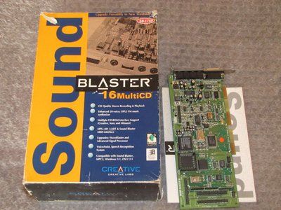

Reply 6 of 65, by boxpressed

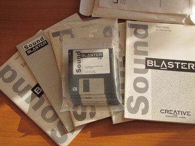

Excellent review. Time to give my CT2230 a whirl. Which set of drivers did you use?
The completist in me wants to know what retail packaging accompanied this card. Does anyone have one CIB? I saw one on eBay sold alongside a Creative CD-ROM drive, so it may have been part of a kit at one point.
The attachment 5.jpg is no longer available
The attachment 4.jpg is no longer available
And a small CD audio cable in a nylon bag (never opened), that fits the small white connectors on both sides
The guy I bought it from kept it really good.

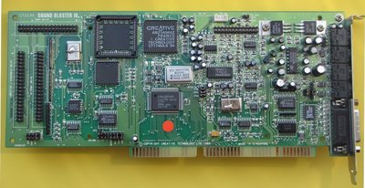

Here is a better pic of my card, I don't think it matches any of the other revisions you linked (mine had C25 populated) - unless old age finally caught up with me 😵
http://i.imgur.com/J86EarS.jpg

It looks like keropi's has only the interface for the Panasonic/Creative CD-ROM, while James-F's has all three interfaces. Probably no difference in performance, I'm guessing.
This is one of the latest CT2230 revisions (49432) with some IDE controllers stripped, and the CT1745-S mixer (no A) along with C25 and L1 next to it.
The mixer timeline goes like so: 1745A (92), 1745-S (93), 1745A-S (94).
I should say again that I believe the mixer chip has nothing to do with the noise level, they simply used what came to hand at the factory, the mixer chips are interchangeable.
No difference whatsoever.

Your's is similar to mine where I have the C25 populated. I guess the CT2230 isn't just a single model, as there seems to be 5 different variations I've seen so far. 3 from James-F's photos, yours, and mine.

There seems to be 5 different variations of CT2230 I've seen so far. 3 from James-F's photos, yours, and mine.
Actually, there are only 3 PCB revisions, not looking at the Mixer chips (and its peripherals), amplifiers chips, CD-ROM IDEs, ASP/CSP, etc..
