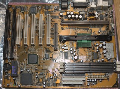

The reason I am asking about this is because I just noticed that the BIOS voltage info screen for my Biostar M6TBD displays a value for -5v but that ATX 2.3 PSU I am using (Thermaltake TR2 430W ) does not supply -5v . I have not actually measured it though .
Is this a bogus reading or could the board actually be generating -5v for the ISA bus ?

Doubtful. Biostar tended to be focused on no or low frills motherboards. If you publish some high res board shots, we can try to play "spot the VRM".

I had a look at my MSI 6147 (ATX, Slot 1, BX, 1 ISA), the -5V rail is wired directly from the ATX connector to the ISA slot. There is no reg in case of a missing -5V rail (that was out of the current ATX specs).
But I had a look at an older machine (Compaq Deskpro 386s), the proprietary PSU does not supply -5V, so they added a 7905 reg next to the ISA slots.

Definitely not the best lighting or lens for a close-up board shot, but it will have to do for now.
I do not see anything close to the ISA slots that could be a linear regulator .
The small chip with nearly unreadable markings close to the ISA slots is a TL 74F32D , so definitely not a regulator .

Nothing there except a couple VRMs for the CPU.

Well I tried another PSU. It is an Arctic Cooling Fusion 550RF (reviewed at http://www.hardwaresecrets.com/arctic-cooling … pply-review/10/) while the previous one was a Thermaltake TR2 430W variant . I can confirm visually that the -5V pin is physically absent from the ATX connector on both PSUs (normal for ATX 2.x units), but the BIOS voltage sensor info displays shows a value for -5V . This value is most likely bogus, but since I neither need -5V (only card that I have that might need it is a PAS16 variant I have somewhere) nor would I want to have the board alarm me as to its absence, I guess I should be happy.
