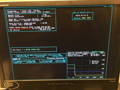

Reply 7 of 12, by nemail
Update: Speedsys shows no L2 cache, although, when booting it shows 256KB in the summary.
Internal and External Caches are enabled in BIOS and jumper cache config is also double-checked.
What could be the problem?

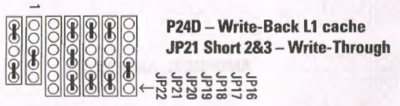

i have
JP16 1-2, 5-6 open
JP17 1-2, 5-6 short
JP18 1-2 short
JP19 1-2, 3-4, 5-6 short
JP20 All Open for 3x clk
JP21 3-4 short
JP22 1-2, 4-5 short
JP5, JP6 1-2 short
according to the pdf manual, the htm files and text file infos in https://www.vogonsdrivers.com/files/ASUS_486S … _and_manual.zip

these are my results:
580.96 KiB
310 views

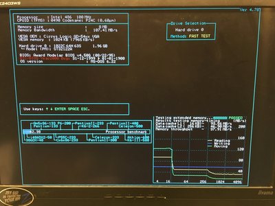

UPDATE!!!!
found it!! basically i had to jumper for P24D, that's really a mistery for me.
156.31 KiB
298 views
new speedsys results:
572.57 KiB
298 views
