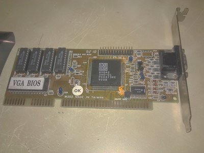

I'm trying to fix a partially working acumos AVGA2 VGA that one of the transistors was removed.
Someone would have equal VGA could tell me which used transistors ?

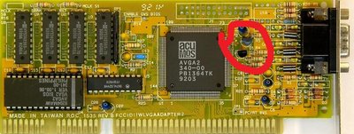

Which one you are missing?
The D1 which is a diode, or Q1, which might be a transistor, but I suspect it is a LM334 reference current generator instead.

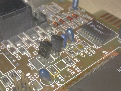

Reply 2 of 7, by adalbert
My revision is a bit different unfortunately, but this is what it looks like. There is a chance that D1 and Q1 will be the same part.

Reply 3 of 7, by Mut
Probably D1 and Q1 are the same.
Thank you for the picture !
Reply 4 of 7, by Jepael
D1 is the "adjustable zener diode" TL431, more specifically, TL431CZ version of it in TO-92 package, by some manufacturer unknown to me (the stylized S letter). Because I don't know the manufacturer, it is quite impossible to know the tolerance of the part, whether it is 2%, 1% or 0.5%.
Q1 is bog-standard 2N3904 NPN transistor in TO-92 package.

Reply 6 of 7, by Mut
I found the same S431 diode on a crappy HMC ISA VGA.
But the acumos still not working.
It starts but sundenly the screen goes black with the message "out of sync", even in the bios.
Reply 7 of 7, by Jepael
If you are connecting it to VGA port of modern TFT monitor, please make sure (read the manual) that it supports 70Hz formats, because many modern TFTs don't.
