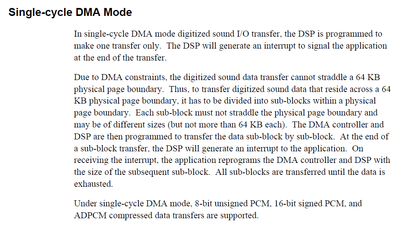

* Single-Cycle DMA Clicking (Non Vibra).
A click will be heard after a sample is done playing with games that use Single-Cycle DMA mode for audio.
All DSP 4.0x to 4.13 are affected including the AWE32.
DSP 4.16 of the AWE64 is not affected, and is free of this bug.
The Vibra cards are not affected by this bug, but have the ringing bug instead.

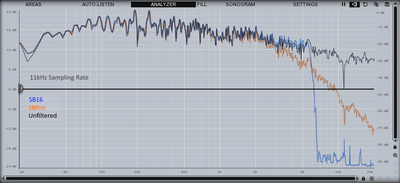

As a side note, the SB16 has dynamic brickwall lowpass filtering which changes depending on the sampling rate frequency,
unlike the SB2.0 and SBPro which have a simple static lowpass filter and is the same for all sampling rates.
The attachment Lowpass Filters.png is no longer available

Here is some more info on how it works:
The attachment Single-Cycle DMA Mode.png is no longer available
Some games like Alien Carnage will use continuous audio stream in single-cycle DMA mode, you will hear a click each time a sub-block of sound ends and an interrupt is sent.
Same thing can be heard in the Wolfenstein 3D Door example where the door opening sound actually constructed of several sub-blocks hence the many clicking sounds DURING the audio stream.
At least this is how I understand how it works.

If you read the Single-Cycle DMA mode description I've posted it reads:
At the end of a sub-block transfer, the DSP will generate an interrupt to the application.
On receiving the interrupt, the application reprograms the DMA controller...
If the DSP (or DMA?) is plagued with this bug, there will be a click at the end of the sub-block or a complete silence after the first sub-block interrupt in clone cards as you say.
So yes, it appears that Single-Cycle DMA mode is one buggy mode even in official Creative cards.
