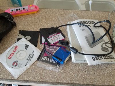

Seriously, this just actually happened. I just bought a new sealed Maxell Parallel port SuperDisk drive. I was psyched to be able to have a way to transfer files from newer to older computers. Previously, if something didn't fit on floppies I had to either connect the old computers hard drive to the new computer, or if it had a CD drive I could try burning a CD but older CD-ROM drives are problematic reading CDs.
The postal service left the package on my porch, where my new puppy was in the yard on his leash. By the time I went out to get it the puppy had torn the package to shreds. The installation disks, AC adapter, and Parallel cable were all chewed up. The AC Adapter I could find a way to replace, but the parallel cable looks proprietary. I only paid 50 USD for it and the only place I can find a parallel cable wants 30USD just for the cable. It would have been really nice to have the original installation disks.
The parallel cable is chewed up in the middle of the cable itself. Anyone have any luck splicing something like this?

Reply 1 of 18, by CkRtech
Are you sure that cable isn't just a Maxell-branded pass-through cable? Iomega had their input/output for parallel just jammed on the back of the external drive.
You could splice the cable (making it notably shorter when you discard the chewed parts), replace the cable, or attempt to hybrid the operation by using a replacement cable for the black end and wiring the other side into the blue.
Do you need a printer/additional parallel device (Covox, etc)? You could just go straight through. Monoprice has one, for instance - http://www.monoprice.com/product?c_id=102&cp_ … &seq=1&format=2. Last time I ordered a few small items from them, the shipping was rather high...but might be worth a shot.
Search around for DB25. That will probably open up many more options.
EDIT: Hmm. Or would you need a Null modem type of cable? My brain is dusting out cobwebs. Nah...it would probably be parallel. You can always check with a multimeter.
Reply 3 of 18, by xjas
If the wires inside the cable are colored it's a (relatively) easy repair: just cut off the broken/chewed side with the DB25 port, test which color goes to which pin with a multimeter, and solder on a new DB25 connector from any electronics shop. It'll be short but work fine. If you can solder well enoug to do the pins on a d-sub connector (which can be kind of a pain) you can fix it.
Reply 4 of 18, by CkRtech
So HD26 to DB25?
Reply 6 of 18, by CkRtech
Do you have some heat shrink available?
Reply 7 of 18, by xjas
Good luck! You can get that to work if you have the patience, but I've tried and it's generally harder than just soldering on a new connector. You'll end up with a short cable anyway but you can always use an extension. Either way it's a straightforward repair, just tedious. ^^ And yeah definitely use heat shrink.
