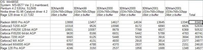

Cool, thanks for posting! I recently did something similar, though with a P4 2.53Ghz and AGP cards, but most of the cards I tested are of the same era as yours. I even tested two of the same model (FX5200 and MX4000). Here are my scores:
64.37 KiB
1207 views
All the details are in the screenshot.
