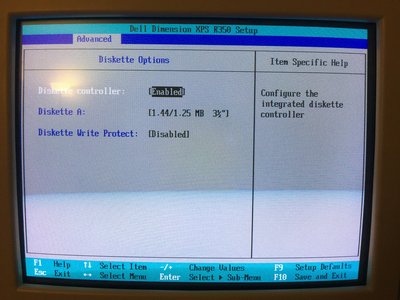

Reply 11 of 37, by Overheat
Hello,
I received the drive today. I've installed it and I'm stuck. So, if you might be able to help me, that would be great. I've tried using both cables that were provided (one has the 5.25" connector, a standard floppy connector with a twist and one without. The next cable has two 5.25" floppy connector one but otherwise is the same) and I can't seem to get both my 3.5" drive and my new 5.25" to appear in DOS. I assumed that one would be a: and the other would be b: but when I try to swap to b: it just uses the same drive again. Please tell me what I'm doing wrong!
Thank you in advance.
Reply 12 of 37, by stamasd
Overheat wrote:
Hello,
Are the drives set correctly in the BIOS?

Reply 14 of 37, by Overheat
This is all I seem to be able to find in BIOS:
The attachment IMG_2123.JPG is no longer available
Reply 15 of 37, by yawetaG
Your computer's BIOS only supports a single floppy disk drive. You need a computer that supports both an A: and B: drive (that is two separate options to set two separate floppy disk drives).
Reply 16 of 37, by Overheat
Oh darn it - so now I need a new motherboard too - this retro gaming lark is hard work!
Reply 17 of 37, by yawetaG
Another option is to buy an external USB 3.5" floppy disk drive, which will work via USB (and not the BIOS). Then you can set the internal drive to the 5.25" one. Or find a floppy disk controller card that you can put in one of the slots, then disable the motherboard's floppy disk controller and use the card-based one...
