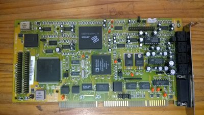

Attached is a photo of my Sound Galaxy Basic 16 sound card (I38-MMSN810) that I bought for myself back in 1994.
My card appears to be revision 1-1A, as printed above the two voltage regulators.
Compared to other photos that I've seen of this specific model (from what I could gather, they were all later revisions), I've noticed that my sound card has two green wires that runs between the AD1848KP Codec chip and the AZT-NXPMIX0592 mixer chip.
What could possibly be the purpose of these two green wires and why wouldn't later revisions have these wires, despite appearing to have exactly the same board layout?
The reason for me asking is that I've recently tested this sound card again and have noticed that with Sound Blaster Pro (8-bit) playback, the output (both FM & digital voices) are "filtered". In other words, compared to my other Aztech Sound Galaxy cards, I have to adjust the treble of this card fairly upwards to make it sound more "clear". Unfortunately, many games and software automatically "disables" the treble to its default setting, resulting in "filtered" playback again.
I was wondering whether these two green wires could have something to do with the "filtering" of the 8-bit sound playback?

Very unlikely that the wires have anything to do with filtering, probably a last minute fix of PCB layout errors.
The Aztech has absolutely no documentation that I could find about their chips.

Nothing regarding filtering. It looks like those are read strobe (RDn) and chip select (CSn) pins, but frankly the picture is not so good as it looks like the other green wire is not directly connected to AD chip.
So perhaps they had CS and RD accidentally swapped so they had to mod it, and either next versions had fixed PCB layout to connect them right or then they fixed the Aztech custom ASIC pins to connect them right.

It could, but it's just more likely it just has less treble by design, because of the mixer chip settings or component values in the audio paths. If there's no data on the mixer chip, we can't really tell.
Does WSS audio (from the AD1848) also sound muffled?

No, it's only the Sound Blaster (8-bit) part that sounds "muffled".
It's not that bad, but after reading James-F's other thread around the output filters on the Sound Blaster Pro, I decided to test out my older cards.
I also have an NXPro, which only has 8-bit output. When I enable that card's output filter, it sounds very much the same as this card's output (despite not having an output filter).
It's possible, as you've stated, that this is by design.
I vaguely recall back in the day of this card's output not always being that clear, but its been a while since I've used it.
It has always been stored in its anti static bag under fairly moderate temperatures.
Although, technically, that is how it is supposed to sound, one is used to hearing cleared (unfiltered) sound output on these older cards.
I guess the only way to confirm this is for someone else, with a similar model, to confirm this. I think the NXPro 16 also had the same components.
