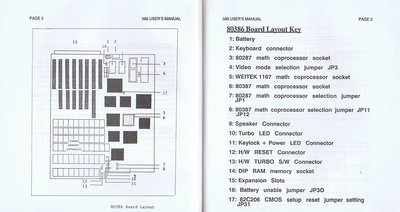

My brother and I tried to revive an old 386 motherboard that he'd used back in the 1980's. When we tried the 386 with nothing attached but a keyboard and an ISA Trident VGA card, the computer made a long continuous beep until we shut it off, and nothing ever appeared on the monitor screen. (Monitor was a CRT -- AOC 5vlr).
We think this 386 may be too old to have beep codes. There's nothing about beep codes in the manual.
There is a jumper setting for monochrome or color on the motherboard (short pins 1 and 2 for color, pins 2 and 3 for monochrome). But neither setting had an effect. Nor did completely removing the jumper so no pins were shorted. In only produced that long continuous beep with nothing displayed on the monitor.
The Trident card worked with a 486 motherboard.
It has a Trident chip on it that says 9000c.
The 386 motherboard doesn't seem to have any identification.
Even the manual only says "386 User's Manual" on it.
I'm attaching a scan of the part of the manual that shows the layout.
Is there any hope for getting this working with a different VGA card?
Maybe the Trident wasn't the best card for it.

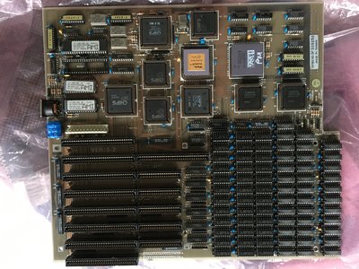

I'm attaching a picture of the board.

Reply 5 of 30, by TheMobRules
Yeah, troubleshooting the RAM is not going to be easy... does the manual specify how many banks there are? I guess you could try removing some of the memory chips and leave only one bank filled to try and discard faulty RAM.
I think your best option right now would be to try another VGA if you have one at hand.
Also, does anyone know the purpose of the slot that looks like 2 8-bit slots next to each other? (the 2nd one starting from the power connector) Is it for some sort of riser card or maybe a proprietary thing?

Reply 7 of 30, by skitters
Bank 0 is the 3 columns of memory chips on the left.
Bank 1 is the 3 columns of memory chips on the right.
When I click the picture to get a close-up, the picture is rotated 90 degrees to the right and Bank 0 is the 3 rows on the top while Bank 1 is the 3 rows on the bottom.
No other ISA cards besides the Trident.
I could buy one if I knew what was most likely to work and it wasn't too much $.

]Also, does anyone know the purpose of the slot that looks like 2 8-bit slots next to each other? (the 2nd one starting from the power connector) Is it for some sort of riser card or maybe a proprietary thing?
Yes, the manual says this
386UsersManual wrote:
High-Speed 32-BIT RAM Expansion Slots
Slot J2/J10 are 62+62 pin slots are available for high speed, 32-bit RAM Expansion cards. The 2MB/8MB memory boards fit in these slots. The slots operate at CPU clock, the same timing as the system board RAM. The board has an operational memory card that uses this slot to add up to an additional 2MB/8MB of memory. As the pinouts are proprietary to the board, only this card can be used in the slot.
My brother said he never used that expansion card.
He also said he stopped using the board when he decided to upgrade to VGA from monochrome.
But he doesn't remember for sure if the board is incapable of VGA.
Reply 9 of 30, by wallaby
It looks like a 286 board. My 286 from that era looks very similar to that. Then again, that's a 386DX 20mhz. A 20mhz 286 would be an extremely fast processor for the time. What a weird hybrid!

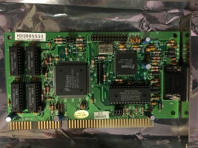

I'm attaching a picture of the Trident card that didn't work with the 386 (but worked fine with the 486).

Reply 16 of 30, by Jo22
Good luck! 😀
Maybe you can get it to work if you set it to 8bit mode.
According to that photo, your card apparently does have a hybrid VGA BIOS (8900/9000).
Perhaps 8bit mode does also force that BIOS to use 8086/80186 instructions (sounds unlikely, I know).
I mean, what else is the purpose of such a mode if you can't use the card in a PC/XT ?
Most 286 or higher machines do have a 16Bit slot and don't need that 8bit mode.
Here's a manual for a 8900D/9000i card:
