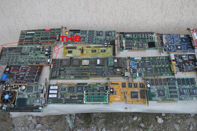

Hi guys. My friend over at the recycling center sent me a few photos of stuff he set apart for me, and I a huge 8 bit isa sound card stood out. After some googling I figured it's a Pro Audio Spectrum. I have a few questions about this card, maybe some of you who are more knowledgeable can help out:
- would this sound card work in an Amstrad 1512?
- is the PaS SB compatible?
- is there anything special about this card?
The attachment DSC_0324.jpg is no longer available
The card is in the upper left corner, encircled.
Reply 1 of 12, by Jo22
In theory, yes, but maybe this card needs -5v like the PAS16.
Nope, it's a standard on its own. 😀 It supports Adlib, though, and you can couple it with a Thunder Board. (or other SB clones)
Yes, it is the ancestor of a whole sound card family. Like the very first SoundBlaster, albeit less troublesome and with better audio quality. 😉
And it has some interesting features, like Dual-OPL2 and "emulation" of the PC-Speaker.
Media Vision Pro Audio Spectrum and Pro Audio Spectrum 16?
But I'm speaking under correction, I'm no PAS owner myself right now (I've got several PAS16s, though).
Reply 2 of 12, by firage
It's indeed a special card. They're sought after but almost never show up on eBay.

Reply 3 of 12, by keropi
the card is nice, just grab it if you can
that 3dfx card on the bottom right though, what is it?
also the other 3dfx card on the top looks interesting, rescue them all! 😎
Reply 4 of 12, by firage
Looks like a 6 meg Voodoo 1. Edit: Actually a 6MB ProComp G105 Voodoo Rush (apparently they're not all AT25/AT3D based - and who knew they could go down to 4MB?).

Reply 5 of 12, by Artex
Amazing find - very rare indeed for the original 8-bit PAS! Hope it works for you! There aren't a whole lot of socketed memory 3DFX cards either - pretty cool stuff imo.
Reply 6 of 12, by Ozzuneoj
Wow, there's some AWESOME stuff in there!
That PAS is really cool and highly unusual... never seen one myself... but there's two Voodoo Rush cards, one of them being one with the (from what I've read) much better and more compatible Macronix 2D chip. Rush cards aren't that easy to come by, especially the Macronix (MX) ones.
Also, a black PCB Voodoo Graphics is quite uncommon as far as I know. Looks like the Biostar card mentioned here:
http://www.thedodgegarage.com/3dfx/index.htm
My hardware collecting problem would be much MUCH worse if people just found stuff like that laying around and gave it to me.
Reply 7 of 12, by kanecvr
Thanks guys. Don't worry, I'm grabbing all the 3dfx cards. I'm also getting the socket 7 SOC and the VLB IDE controllers.
Wow, thanks for IDing it for me - I was actually wondering what it was.
Yes, the MX based Rush is a Procomp, while the AT25 based card is an Atrend.
@joe and firage - thanks. The Amstrad is an XT machine and I think it has a -5v rail. I'll try it out.
Reply 9 of 12, by carlostex
You really hit the jackpot with that PAS...
Reply 10 of 12, by sirlemonhead
The Amstrad DOES have a -5v rail 😀
Reply 11 of 12, by bristlehog
AFAIK 8-bit PAS doesn't even require a -5v rail (unlike most of its 16-bit successors).

Reply 12 of 12, by carlostex
Correct.
