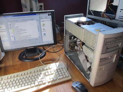

Hi guys! 😁
Recently I picked up a generic Pentium II rig off of ebay for about $100. It came from one of those e-recycling places that sell old computers without hard drives and this one caught my eye. More specifically, the HP Colorado T3000 tape drive caught my eye. But it came without a hard drive, so I threw in an old 20 GB drive from another tower I was scrapping out and installed 98 SE on it.
It's a Baby AT case with a motherboard in it supporting both a Socket 370 cpu and a Slot 1. Currently it's got a Pentium II MMX slot 1 running at 400 mhz, with 96 MB of RAM. I'm trying to figure out the motherboard's make and model, and the closest I've got is "PII Slot-1 242P" inscribed on the side of the slot 1 slot.
The problem is, everything is integrated. Ribbons connect everything to the board, nothing is taking advantage of the 3 PCI local slots on the board. There are some chips which might help me get drivers if I copy down the models of them. I'll do that tomorrow, don't feel like opening the case right now (it's a pain to get off and on 🤣 )
Just posting here to possibly see if anyone has any helpful info to help get drivers for it so I don't have to just use generic 16 color VGA and no sound or anything 😀
Thanks!
~CJ

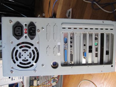

Reply 1 of 18, by cj_reha
Here's a photo of the back. Interestingly this board even supports an (presumably 10 Mbps) Ethernet port, as well as modem, USB, and a few other interesting things.

Reply 2 of 18, by SRQ
A Pentium II with 370 and Slot 1 in an AT form factor? What in gods name... that is the oddest thing I've seen this week.
First step is going to be to identify the chipset either through the bios or otherwise. I find a temporary install of Windows 2000 or XP just so you can get info from device manager helps. Then get info for the rest of the parts and track down drivers.
If you look on the board for the physical chipset there's a good chance you can get an ID there and then get drivers. Trying to find the original OEM drivers is both a bad idea due to those never getting updated, and because often those OEMs simply cease to exist.

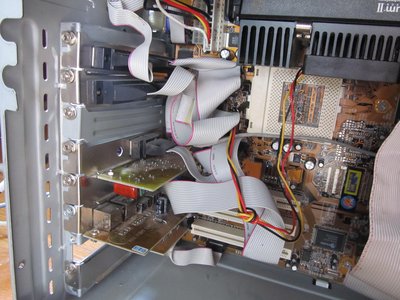

Reply 5 of 18, by cj_reha
These are older pictures I took when I'd just gotten it. I'll follow up tomorrow with more detailed photos.
Here's a pretty bad one but it's all I've got for now.

Reply 6 of 18, by Brickpad
Could it be an Asus board? I see what appears to be one of those special ATX-like expansions cards, or whatever they were called, that had PS/2 and USB headers that connected to the board via ribbon cable.
Also, for future reference, that case is an Enlight Exacta 6552

Reply 8 of 18, by Kamerat
This is your motherboard:
http://zenux.ru/media/other/%D0%9C%D0%B0%D1%8 … 11-22-48-40.jpg
http://blackcatlinux.narod.ru/trash/M766LMRT.pdf

Reply 10 of 18, by Anonymous Freak
Kamerat wrote:
Wow. That is one amazingly full-featured baby AT motherboard! 10/100 NIC (unsurprising as it's 810 chipset,) sound, everything. Heck, even in a full AT case, there are so many rear panel brackets that you have to use up one of the PCI slots' panel locations to use them all!

Reply 12 of 18, by Kamerat
Anonymous Freak wrote:
Looks like it even got a SB-link connector. You can usually mount serial and parallel ports directly on the AT case to save some brackets.

Reply 14 of 18, by cj_reha
It appears that before I could copy down the chip names Kamerat figured out the mainboard 🤣
