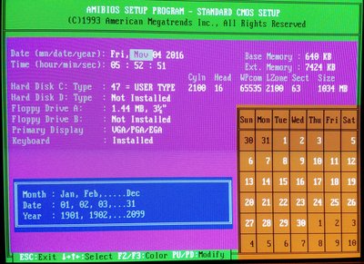

I've got a Seagate ST51080A 1GB hard drive connected to an ISA controller card with UMC chipset. The BIOS autodetects the drive correctly:

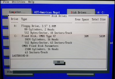

But MS-DOS only sees 503MB:
1.88 MiB
712 views
MSD seems to be differentiating between CMOS parameters the parameters that DOS is using.

Reply 1 of 7, by Jepael
It seems the BIOS is not able to do geometry translation. So it can detect the drive parameters (note 2100 cylinders) alright, but as BIOS disk interface what DOS uses can only have 1024 cylinders, it is limited to 504MB.
2100*63*16=1033 MB
1024*63*16=504 MB
Later motherboards do geometry translation, they halve the cylinders while doubling the heads until it fits into 1024 cylinders.
Or anyway use the disk as LBA, but still present max CHS parameters via BIOS disk interface.
Fix: use disk overlay of some sort.
Reply 2 of 7, by clueless1

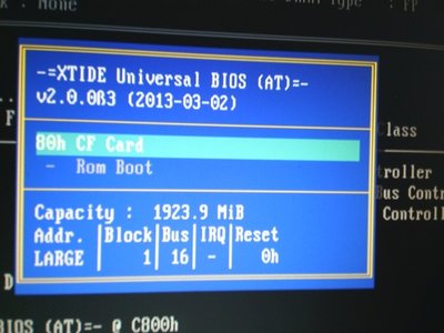

Edit: Just checked, XT-IDE BIOS detects my large CF card.
I used a D-Link DE-220 card as a host. Booting DOS worked fine so far.
