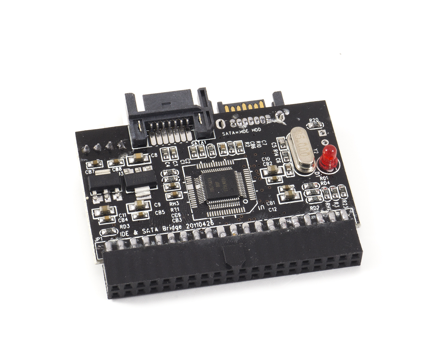

    Today I got from a retail store a bidirectional SATA-IDE/IDE-SATA adapter, but I haven't had a chance to try it out yet because I'm currently short of HDDs.
    I'd like to know from someone that has tried these things if there are some known compatibility issues, for example if SATA HDDs don't appear as IDE, causing problems in the installation of certain (DOS) operative systems.

    Reply 10 of 24, by Elia1995
    The adapter I bought is like this one:
    Look at the soldering..
    Reply 12 of 24, by Elia1995
    Mine has perfect soldering, that must be one unlucky guy 🤣

    Reply 14 of 24, by stamasd
    The adapter in the picture above is very similar if not the same as the ones that worked for me. Of course YMMV.
