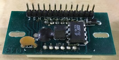

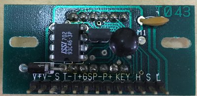

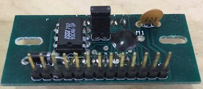

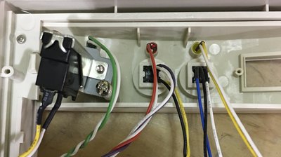

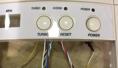

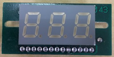

I have no idea what to do. There are no jumpers and it seems like some front panel LEDs and such hook directly too it. I should have taken pictures before I realized they probably weren't just jammed on there for no reason. The switches are odd too, like the reset button has two sets of wires. One going to motherboard and one going to LED, I think.

This is only my guess:
V+ V- (5 volt power source)
P+ P- (Power LED)
T+ T- (Turbo LED)
KEY (Keylock)
GS, S, S (Ground?)
H (???)
L (???)
ISSI 93C46 is an EEPROM chip. Not sure what is under the epoxy resin bubble, but I suspect this LED is programmable. I also suspect the extra wires are

Reply 5 of 7, by squareguy
Google search finally got me this. This is probably how it is programmed. (Vogon's search doesn't work too well for me)
From this thread MHz display pins
Malvineous wrote:
I've seen some "programmable" MHz displays where you held the reset button down for a few seconds and the number on the display would rapidly increase to 999 and then wrap around to 000 so you could change the number displayed when the turbo was on or off without messing around with jumpers.
I wonder whether that's what the three lots of two pins are for? Power, turbo LED and reset switch?

Reply 7 of 7, by squareguy
I do not know how to fully setup this thing but I can get it to do what I need.
I have not figured out how it connects turbo to motherboard. I am running another set of wires off of the turbo switch.
V+ V- (5-Volts Power)
S (Unused)
T- T+ (Turbo LED)
+6S (Unused)
P- P+ (Power LED)
KEY (Second set of wires from Reset Switch (this programs it))
H S L (Turbo Button, 3-wire)
I played around with several configurations and the two unused connections and this is what I got to work.
