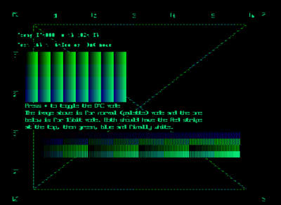

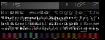

Reply 1 of 19, by superfury
After the latest fix to the ET4000 DAC(16 vs 15-bit color detection, although I've made a typo in the commit saying 15-bit vs 16-color instead), this is the result of the WHATVGA application running the 16-bit DAC test:
Normal mode:
44.21 KiB
1471 views
Capture in the 'normal mode' (before pressing + or after pressing + to return to this mode)

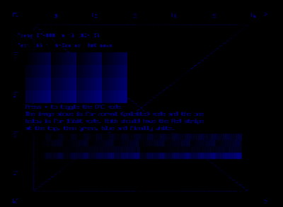

Other(Color) mode, toggable by pressing +:
31.17 KiB
1471 views
Capture in the 'color' mode(after pressing +)

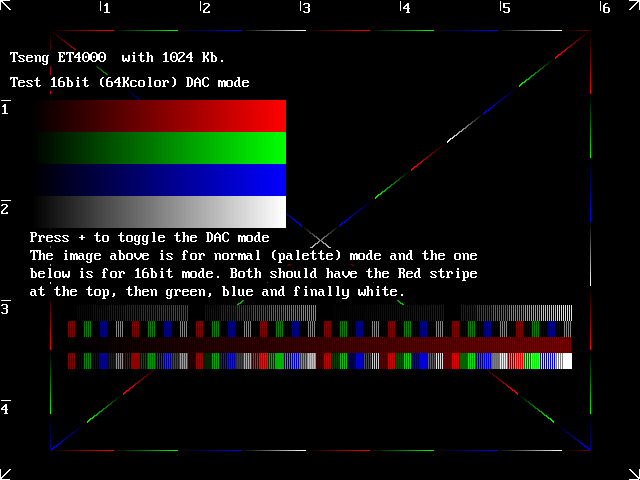

Dosbox capture of the same screen(+ has no effect):
9.89 KiB
1471 views
Dosbox screenshot (Dosbox 0.74) of the "Normal" DAC's 16-bit color test.

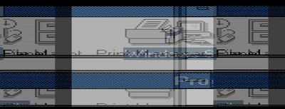

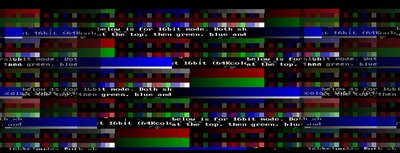

Now, the normal mode is stil the same (it uses VGA-mode rendering for some strange reason on my 8088 emulation, combined with the DAC set to mode 7h(DAC Command Register set to E0h). Logically speaking, the ET4000 should be set to use mode E0h(DAC) with Hi-resolution 16-bit colors set in Attribute Controller register 16h bits 4-5(set to 11b)? But for some reason, the Attribute Controller register is set to 00h(Indicating VGA mode???)?

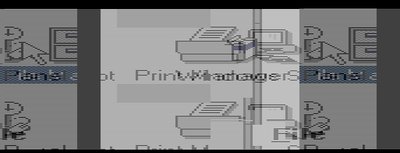

Screen capture after pressing + now:
44.22 KiB
1416 views
ET4000 DAC in 16-bit color mode, ET4000 itself in 4-bit mode(VGA compatibility mode depending on 8-bit setting in Attribute Mode Control Register, which is 0).

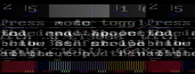

I've just tried the given code on the ET3000 graphics card emulation:
43.7 KiB
1414 views
ET3000 DAC in 8-bit color mode. ET3000 itself in 8-bit color mode. Switching to 16-bit mode using + causes the whole display to become bluescale.
UniPCemu Git repository

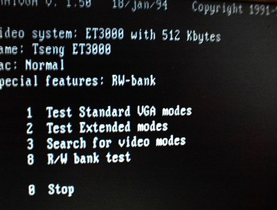

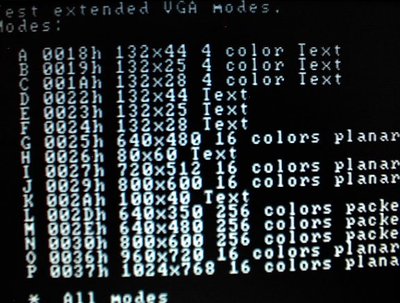

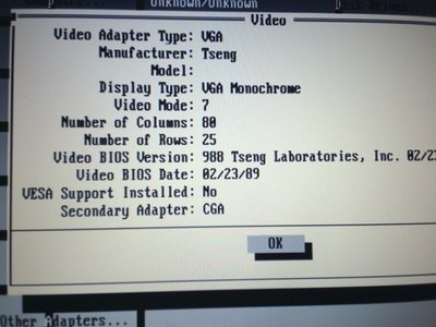

I've looked at what the WHATVGA application does when it tries to test the 64K color mode. It, for some reason, doesn't set the Linear Graphics mode(as documented in the ET4000 documentation), not even on the ET3000? So it starts reading and writing VRAM in planar mode(while it's format suggests(when forcing linear mode)) that it's expecting the Linear Graphics mode, even though the Chain-4 bit isn't set? Anyone can explain this? Or does this mean there's a serious bug in my CPU emulation?
What's set on a real ET3000 w/ Sierra Hi-color DAC?
Edit: I've left the used base mode at the default mode, but it should be a 256-color modes as far as I remember the list of base modes. Since it uses a 256-color base mode(confirmed in the rendering), it should enable the Linear Graphics mode by setting the Chain-4 bit(bit 3) in the Sequencer Memory Mode register? Anyone knows if there's a reason the ET3000 BIOS doesn't set it? Is this a bug in my 8088 CPU emulation? Vladstamate?

This is the current result of the WhatVGA's 64k color test(using the default display mode settings):
143.74 KiB
1203 views
UniPCemu's WHATVGA 64k color test(defaulted settings)
163.96 KiB
1203 views
UniPCemu's WHATVGA 64k color test(defaulted settings), after opening and closing the Settings menu(which updates all (S)VGA precalcs).
Anyone can see what's going wrong? Is this simply because of some bug in my 8086 emulation? Does WHATVGA's 64k color mode even work on a 8086/8088 CPU?
Edit: Seeing as the results change when I open and close the Settings menu(which completely(WHEREUPDATED_ALL is used as it's parameter to update all VGA registers and CRTC timings) updates the precalcs used in the (S)VGA emulation) during the drawing process and after the drawing has finished changes the output, this leads me to believe that there's actually a problem with calculating the precalcs somewhere? So the precalcs aren't updated in 100% of the cases where it needs to be updated?

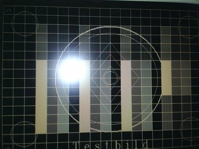

superfury wrote:
Also, does WHATVGA work properly with an ET3000 8-bit color on a XT? (I'm using mode 2E 640x480x256 mode afaik). I'm testing the 64K mode of the Sierra Hi-color DAC with that mode.
Hi superfury, I tried my ET3000 in my XT machine..
And the good news is: Well, yes, WHATVGA istelf does run on a PC/XT with 8088 processor.
The bad new is, however, my card does only offer 512KiB, a normal DAC and I can't disable the on-board CGA.
So I'm afraid any serious testing is gonna fail. Anyway, I took some pictures for you.
    82 KiB
    1167 views
    86.12 KiB
    1167 views
    71.92 KiB
    1167 views
    84.9 KiB
    1167 views
    94.68 KiB
    1167 views

Edit: I've checked the log until 00:04:43:58.04448, where it's busy processing the DAC color entries. Everything until that point seems to process the registers (Sequencer, CRT, Graphics controller, Misc registers) correctly.
Edit: A screen capture of current progress:
171.64 KiB
1123 views
Windows 3.0 Mode 2Eh ET3000 graphics boot
Does this meean that the memory is wrapping too much? Seeing as the lines break up halfway or earlier consistently, it seems there might be a problem in scanline offsets(offset register incorrect?)?

I've improved the precalcs some. Now it gives me strange stuff after opening the Task manager of Windows 3.0 and closing it:
208.79 KiB
1121 views
Anyone can see what's going wrong here?

I've just patched the ET3000/ET4000's new precalcs for memory modes to patch the incorrect Sequencer Memory Mode register value of 6 to apply memory as if it's set to 0xE instead(temporary patch). Now Windows 3.0 shows better content, but WHATVGA shows something really strange:
325.05 KiB
1094 views
WhatVGA with the Sequencer Memory Mode register being patched to it's correct value.
It looks like memory is being wrapped around a very small address, seeing as it's overwriting memory in an invalid-location way(that's what it looks like to me)?
