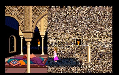

Reply 1 of 7, by superfury
I've made some little screen captures of the opening animation of Prince of Persia (MS-DOS version):
269.61 KiB
515 views
Animation starting during the Prince.exe opening animation, showing the princess and flames correctly, background is messed up.

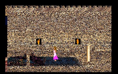

269.39 KiB
515 views
Animation is running. The wizard and the hourglass show up correctly, background still incorrect.
It's running on the NEC V20/V30 CPU(Essentially just a 80186 in a PC XT).
Source code of the used CPU-specific functionality, implementations of the 8088/80188 cores:
https://bitbucket.org/superfury/unipcemu/src/ … 086.c?at=master
https://bitbucket.org/superfury/unipcemu/src/ … V30.c?at=master
It's used with 8-bits bus size, 80188 instructions(8086 and NECV30 core combined).
Anyone can see or knows what's going wrong here?
Edit: Currently, after some testing, it seems this is caused by the MIDI rendering screwing up the game somehow(on the NEC V30(actually 80186 without other enhancements than the new instructions) emulation)?

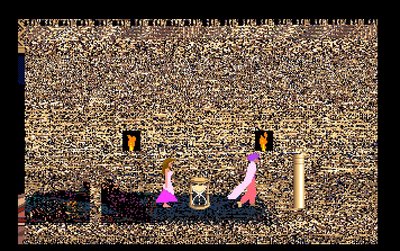

Reply 3 of 7, by superfury
I've just tested the XT 80186(Reported as NEC V20/V30 depending on 8/16-bit bus) emulation with the hardware passing the MIDI commands through to the OS(Windows 10). Sound works without problems, but when the (Dosbox version adjusted)MPU-401 is used(passing through to Windows, essentially the same thing Dosbox does) the output of Prince of Persia is messed up?
225.24 KiB
463 views
Prince of Persia MS-DOS on 80186 XT PC emulation(UniPCemu latest commit). Display is messed up with Dosbox MPU-401 emulation enabled only?
Edit: Oh, btw, the MPU-401 is hardwired to IRQ 9. I don't know if that causes any problems (Since IRQ9 isn't used normally on the XT)
UniPCemu Git repository

After looking at the Dosbox MPU-401's MPU401_Event function(which runs in a seperate thread), it doesn't use ANY locks. That could cause some corruption in the application due to both threads accessing the MPU emulation, causing corruption? It would need to be moved to the main thread instead.
Edit: Moving it to the main thread fixes that issue, but Prince of Persia is still buggy at that point. Anyone knows what might be the cause(Fixing the IRQ handler done on the UART seems to fix the mouse bug that's been around since I've implemented the 80286 😀 Now the mouse works properly again(With modern IRQs and full 8-bit range(instead of the previous 7-bit range(-64 to +64 range in 8-bit signed values) used in all releases up till now). )?
