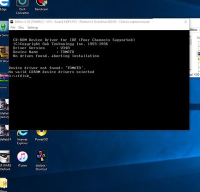

I am having this problem after using the WIN98C floppy image fidsk program in order to format my Hard disk images with FAT32 I came across this problem in this pic I took.
Battler if you are seeing this please post on what I should do to fox this problem.

Can you post a screenshot to understand the sequence of events leading to the error message?
Reply 8 of 17, by DOSfan1994
Here is what happened.
I'll tell more in my next post.

    I am in Win98C floppy and I have fdisk as my command.

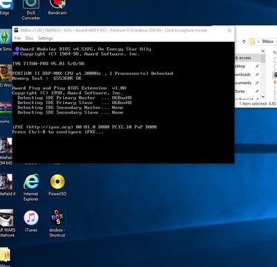

    The bios detect my hard drives.

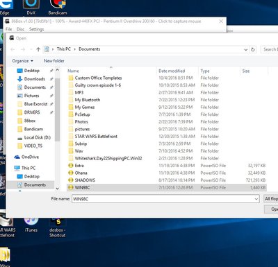

    Meanwhile I use my WIN98C floppy image file for FAT32 support

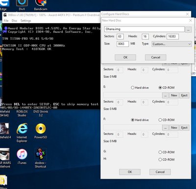

    First, I make my first Hard disk imagine and called it what ever I want.

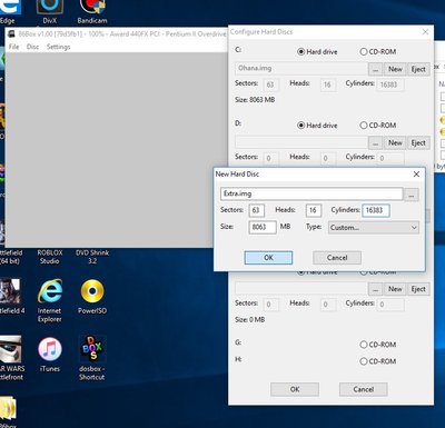

    Next I made another Hard disk imagine for extra space for my Windows 95 VM
Reply 9 of 17, by Battler
1. Mount hard disk image;
2. Partition it with FDISK;
3. Reboot;
4. FORMAT C: /S;
5. Remove floppy and reboot from the hard disk image.
Also preferably disable the network BIOS, as it might mess with booting.
Reply 11 of 17, by Jorpho
Some network cards have a specific ability to boot from a drive stored elsewhere on the network, but I doubt that is a feature supported by 86box. So, don't worry about the "network bios".

Reply 14 of 17, by Battler
86Box does support booting from the network, and one of his screenshots clearly shows the IPXE BIOS loaded, and I know for a fact it has a risk of making hard disks unbootable on 86Box, hence why suggested he turns it off.
