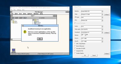

I was trying to play a Living Books game I enjoyed back when I was in preschool to relive some great memories with these games on PCem with using Windows 3.1, and when I tried to install it I got this error. I made a screen shot of it to show the problem. And I think it's the system RAM not my hard disk space of 8gigs (And I am running windows 3.1 on a FAT 32 partition above MS-DOS 7.1 and it has "w3xstart.exe" which makes you use Windows 3.1 on a FAT 32 hard disk.) I am using Award 430VX and it's RAM limitation is up to 256 MB and WIndows 3.1 thinks it's not enough. With a new PCem version on the way around late January of next year I hoping that this will be resolved if a Intel 440FX with 640 of memory ram is emulated which I don't think it's a possibility right now because the Dynamic recompiler is not fast enough for Pentium II/Pro emulation. Right?
If you have any solutions to the problem feel free to leave post.

    Here is the screen shot of the problem I encountered.
Why on earth would you think that? No one had an 8 GB hard drive when this game was released. Use a smaller hard drive image, and if that doesn't work, then use MS-DOS 6.22.
Better yet, just use ScummVM, which already supports the Living Books.
Reply 3 of 21, by Jorpho
DOSfan1994 wrote:
It's the system memory Ram.
No one had 256 MB of RAM when this game was released either, let alone 640.
Reduce the RAM to something like 32 MB or 16 MB.
Reply 5 of 21, by vladstamate
There are few things you can try.
1) Change the amount of virtual memory in Win 3.1. It is somewhere in the settings/preferences. Set it to something like 2x your actual physical memory (of your virtual machine).
2) Play around with amount of physical memory in the virtual machine. Try 32, 64 and 128.
3) Although unlikely as it is probably running in protected mode, it might be complaining of missing base memory (and not upper/high). In that case mess around with your config.sys/autoexec.bat. Do things like "DOS=HIGH" and do not load sound card drivers.

Reply 9 of 21, by Jo22
As the others said. 256MB is a bad idea, since it conflicts with virtual memory.
Something like 8 to 64MB is way better. If you really have Windows 3.1 and not WFW 3.11, also try Standard Mode (win /s).
Otherwise yu can also try to disable virtual memory (Win32s might require it).
It can be disabled in control panel under 386 enhanced section.
Also make sure you don't use any memory managers, Win 3.1 doesn't require that (its own himem.sys is fine).
Windows 3.1 likes to handle the memory right below 1MB on its own.
https://support.microsoft.com/en-us/kb/84388

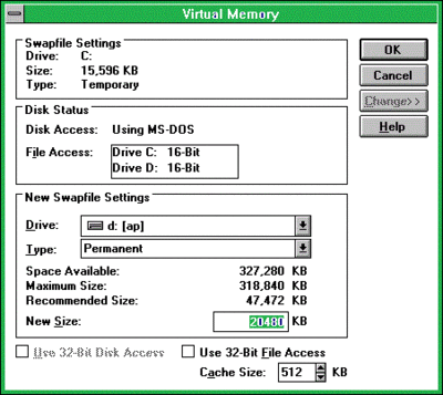

Reply 11 of 21, by vladstamate
No that is not what he said. He said you need to go inside Win 3.1 after you start it and go to Control Panel and then 386 Enhanced section and from there disable (or change the size of) the virtual memory managed by the Win 3.1 itself.
Reply 13 of 21, by Jo22
Under Virtual Memory > "New Swapfile Settings".
Change "Type:" to "none".
No idea it that helps in your case, though.

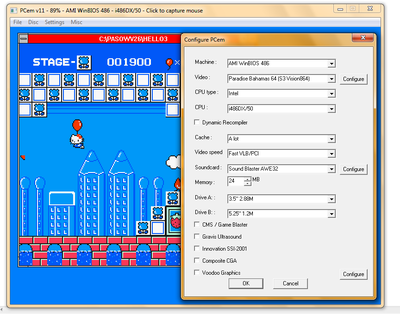

Reply 16 of 21, by Jo22
Another idea, also try to uncheck "Dynamic Recompiler" and load the older himem.sys (just to make sure).
To do so just change config.sys to have this line: device=c:\windows\himem.sys.
If this doesn't help, change the emulated machine to something more 1994-like, say a 486DX33 or so.
My current setting looks like this (not ideal, but works for most things):
