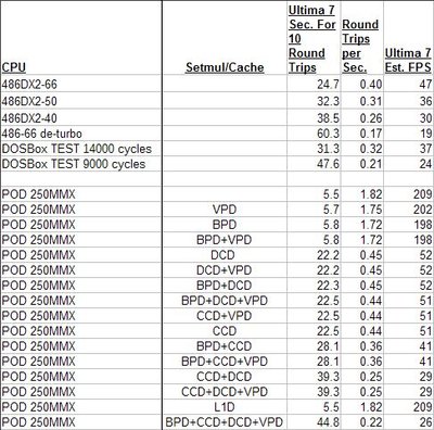

Guys, I've come up with a way to measure performance in U7. This game is famously missing any sort of frame limiting. Various discussions here and on nerdlypleasures.blogspot.com have talked about this. The consensus is that the perfect speed for this game is a 486/33, with the game quickly becoming unplayably fast as you approach 486/66 speeds and higher. So this is a way for you to dial in the "perfect" speed if you're lucky enough to have an MS-DOS system with the ability to adjust speeds without disabling L1 cache (or if you're playing in DOSBox and adjusting cycles). You see, another thing U7 is famous for is being immune to disabling L1 cache. Somehow it's able to re-enable L1 as you start the game. I've found that U7 is NOT immune to L2, turbo, and manipulating Test Registers via Setmul (if you have a Pentium that supports these test registers, which I do 😎 ).
The premise around this idea is that there are at least a couple of constants in this game that can be measured with a stopwatch. These include the pacing guards in the towers of the opening scene, the waving flags at the guard towers, and the clock ticking sounds, which all speed up and slow down depending on system speed. I found that the pacing guard is the easiest to measure with accuracy. I will demonstrate with a YT video in a bit.
So I tested this on my DX2/66 with and without turbo, as well as downclocking the cpu to DX2/40 and DX2/50 speeds. The units I use are "Seconds per 10 round trips" for the guard pacing, which I convert to "Round Trips per Second". I did this test at numerous speeds with my POD250MMX, using the Test Registers, as well as the aforementioned real 486 speeds. In the chart below, the Test Register switches I use are in the "Setmul/Cache" column. While I don't have a real 486/33, I did come close with my DX2/40 by using a 20Mhz bus speed on my 486 motherboard. I'm hoping others here can duplicate my tests on their systems, and someone with a DX/33 might be able to confirm my estimate of the "perfect speed".
One other thing I did, which you can help me fine-tune, is estimated a real 486/33 based on the results I got at 66Mhz and 40Mhz. I made the assumption that at the "perfect" speed of 486/33, the framerate is a "perfect" 24 FPS. With these assumptions, I came up with a factor of 115, which when multiplied by Round Trips per Second, gives an accurate-looking framerate. Here's some results:

Here's how I measure. Start a new game, click through the dialogs, then use the keyboard and right-arrow over towards the guard tower. As soon as you take the first step under the tower (the waving flags will disappear), take one step back to the left. Save the game here to make it easier to get back to this point. This is the position I always measure from to try and keep as much consistency as possible. Using a stopwatch, keep an eye on the pacing guard. When he's at the bottom and turns around, start timing as soon as he reaches the top. From there, just count 10 round trips of his pacing, then stop timing when he reaches the top the 10th time. Divide this result by 10 to get "Round Trips per Second". Then multiply by 115 to get an estimated FPS.
There are some variables that can't be controlled, such as the guy in blue and the dog wandering around, but after taking a bunch of results I can conclude that the results are VERY consistent.

By default, my GOG version of U7 was set to 14000 cycles. As I measure, it plays at about 37 FPS. When I walk around, it does seem a bit too fast, but not unplayable, so 37 sounds close. If I slow down to 9000 cycles, I get my target 24 FPS. I demonstrate all this in the video above.
What do you guys think? Would anyone with a 486/33 care to try this and see if it takes about 47 seconds to complete 10 round trips? Assuming this is pretty consistent, does labeling this at 24 FPS sound accurate?

I just tested with my 5x86-120. I set the FSB to 25MHz and then tested with the 3x and 1x (via SETMUL) multipliers.
I tested twice for each speed. The first run was close enough to the second run, so here are the times for the first run only:
5x86-75: 17.75 seconds
5x86-25: 39.75 seconds
So it looks like the 5x86-25 is close to a 486DX2-40, which sounds about right.

Nice. And the 5x86-75 is 39% faster than my DX2-66, which would put it around DX4-100 speeds.

I don't know if anyone ever actually ran your Ultima 7 benchmark on a real 486DX-33 but to get 25 FPS in Ultima 7 on the Ezra I had to use...
66x3, ICD.
In contrast, System Information gives it a rating of 45.5 (compared to a 486DX-33 which is 71.2) , SpeedSys gives 21.50 at this speed and Doom has 9.37FPS.
Meanwhile, at 103x3 with ICD Sys Info gives a 70.2 rating but Ultima 7's FPs is exactly 40.

So I recently discovered the fdapm speed settings, and decided to test Ultima 7 with it. Then I searched and found this thread, so here are my results:
My machine is a Pentium III-450.
Stock setting is pretty similar to the original post in this thread ~205 FPS and way too fast.
FDAPM SPEED1 results in 58 seconds for 10 round trips, or estimated FPS of 19.83
FDAPM SPEED2 results in 25.7 seconds for 10 round trips, or estimated FPS of 44.74
FDAPM SPEED2 + SETMUL L2D results in 29.1 seconds for 10 round trips, or estimated FPS of 39.52

So I got the numbers with the u7dcp patch and l1 cache disabled:
148.4 seconds for 10 round drips, or estimated fps of 7.5.
I think the ACPI speed throttle is a much better solution for my PC.
