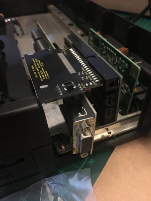

Were low profile cards a thing in the 1980s? IIRC this machine only has CGA so a VGA card is advisable.
"AI Requires Proof That You Are Human"
Reply 2 of 22, by lazibayer
The profile is really really low.
Reply 3 of 22, by Errius
That would work. I see this machine it doesn't have a screw bracket for expansion cards, just a removable panel in the side of the case.

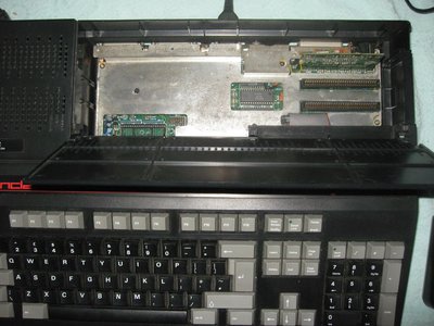

Pics attached of the expansion bay for this model
eta: I assume that if this machine had been a success Amstrad would have released special expansion cards to fit it. Maybe even a 5161-type expansion chassis. As it is the expansion options are very limited, at least if you want to run it with the lid closed. Has anyone ever made a DIY expansion chassis for computers with limited ISA slots?

Reply 17 of 22, by -B-
Hi All,
I run a PC200 Facebook Group where we discuss such things. Search for "PC200 and PC20 Users"
My own PC200's have been upgraded to 640K, V30 processor, 8087 co-processor, low-profile VGA card (like the one shown above), 4GB CF HDD (2x 2GB partitions under DOS 5.0) and home made external FDD.
Join the group and ask away.
