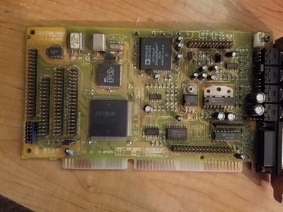

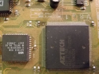

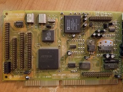

I have been trying for days to get the correct drivers installed for this card. I have used Sound Galaxy Pro 16 II, Waverider 32 and Nova16 drivers, but with each install, I receive a "sound card not detected!!!" message. I am running pure DOS 6.22. Checking the config.sys and autoexec.bat, paths and filenames are all correctly generated by the installer. I attached images of the card I have, but here are the details:
2316A chipset
Sticker on back: MM PRO 16F EP (M)
FCC ID: I38-MMSN830 - This is registered as Aztech/Trust Sound Expert DeLuxe 16+
Tried moving jumper to EEPROM mode
The card works perfectly as a SB Pro clone otherwise, but I really want to get it configured correctly. The gameport is not working and I assume that is because I need the right drivers.
Any ideas?

Reply 1 of 6, by sprcorreia
Packard Bell card... You should try to get the drivers from Packard Bell.

Reply 2 of 6, by jesolo
I have the drivers for that model (and the one for I38-MMSN824, which is also a very common Aztech OEM card with no readily available drivers).
Attached are the drivers for both model number I38-MMSN830 & I38-MMSN824 (the latter was shipped with the Voyager Multimedia Kit).
Please note that you need to install these from floppy disks (or use a floppy emulator):
