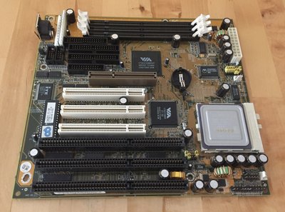

So, I just got hold of this Chaintech 5AGM2 SS7 board.
340.49 KiB
1712 views
Does anyone know if it supports a K6-3+ with the latest BIOS?
If so, since the lowest you can set the voltage with the jumpers seems to be 2.2V (according to what's written on the board itself), is there any meaning in getting a 1.6V 400MHz K6-3+ or should I get a 2.0V 450 MHz or higher?

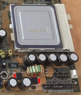

Is there any way to measure this voltage with a multimeter?
44.22 KiB
1618 views
Points of interest highlighted in red.
Vcore is probably going through that large inductor (in between the MOSFETs and the row of caps). If that's not easy to safely reach, then you can also try that pair of MOSFETs. Try the tabs first, they should be easy to reach and one of them probably has Vcore on it.
Try setting the jumpers to a known value and see if you can get Vcore at any of those points. If not, then (carefully) try the other 2 legs on each of those mosfets. Somewhere on those mosfets you should be able to find it. Just put the negative probe on an easy ground like the side of the PSU.
Once you've found the expected Vcore, then you can test undocumented settings.

Finally got my K6-3+ / 400MHz 1.6V chip from Germany and could test this out.
If I remove all jumpers in the hope of making it 2.0V the computer won't POST at all.
The manual I have (which seems to be for a different revision) does not give any hint about what removing all jumpers will result in, nor does it mention what happens if you short pins 9-10 of JP4.
Fortunately, I can set the core voltage to what should be 2.1V by shorting only pins 1-2 of JP4 (also undocumented) which seems to work fine.

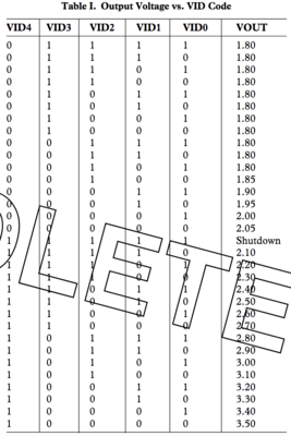

I know it's an old post, but just for reference ct-5agm2 uses ADP3152 voltage regulator, jp4 sets the 5 bits used by the VR to correctly output the desired voltage. ADP3152 can drive the 2 mosfets to output from 1.8V to 3.5V in 0.05 increments up to 2.1V and then 0.1V increments up to 3.5. Chaintech old website FAQ (which can be accessed trough WebArchive) about this motherboard incorrectly reports that 2.0V setting is achieved removing all 5 jumpers from jp4, which instead sets all 5 bits to 1 and forces the ADP3152 in shutdown state, so the mobo will not boot. The correct jumpers position for 2.0V is 1-2 open 3-4,5-6,7-8,9-10 closed.
NOTE: This is referred to 5agm2 rev. F150 please check your revision as stamped on the eprom chip and your VR chip markings before using the jumpers settings provided here. Other revisions might use different Voltage regulators. Revision D150 uses EL7571CM which from the datasheet could range from 1.3 to 3.5V if I'm not mistaken, 2.0V remains the same as ADP3152 (1-2 open 3-4,5-6,7-8,9-10 closed). Since they all seems to be Pentium2 compatible VRs the 2.0V setting should be always the same since on slot1 the 5 bits is supplied by the cpu and not jumpers selectable, but please check before applying.

I know it's an old post, but just for reference ct-5agm2 uses adp3152 voltage regulator, jp4 sets the 5 bits used by the VR to correctly output the desired voltage. Adp3152 can drive the 2 mosfets to output from 1.8V to 3.5V in 0.05 increments up to 2.1V and then 0.1V increments up to 3.5. Chaintech old website FAQ (which can be accessed trough WebArchive) about this motherboard incorrectly reports that 2.0V setting is achieved removing all 5 jumpers from jp4, which instead sets all 5 bits to 1 and forces the adp3152 in shutdown state, so the mobo will not boot. The correct jumpers position for 2.0V is 1-2 open 3-4,5-6,7-8,9-10 closed.
Just for augmentation... here is the list of all voltage settings.
