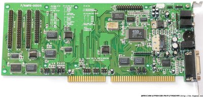

There are early ESS cards with jumpers and even OPL3, but I've only ever seen one such card for sale:
558.34 KiB
