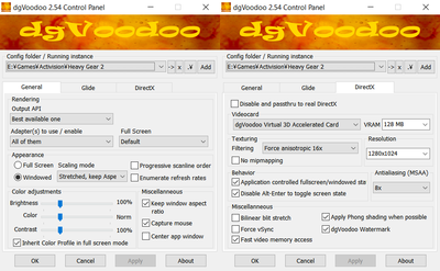

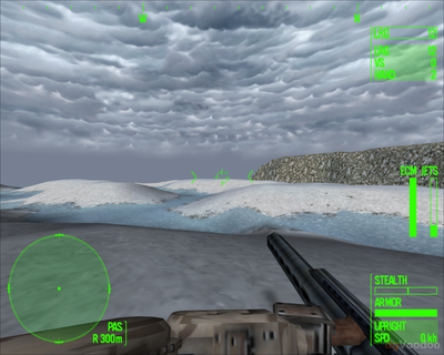

Reply 2 of 5, by VR7
I tried some of the WIP builds, as well as the latest stable release (2.54). There doesn't seem to be any effect so far.
If it helps, I've attached a screenshot of my current settings and a screen of what the game currently looks like; though it pretty much looks the same as the screenshot from the post that shares the same issue.
Edit: Fog works in Heavy Gear 1 if you use Direct3D instead of 3Dfx, so it might have something to do with the way the sequel handles fog.
    1.11 MiB
    1405 views
    In-game screenshot
    76.79 KiB
    1405 views
    dgVoodoo settings
-VR7.
