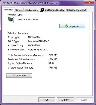

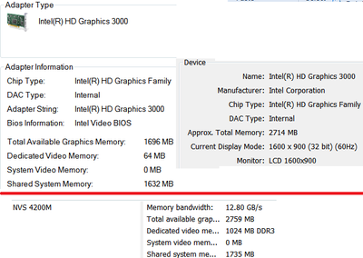

Reply 1 of 5, by kevsmudge
If you don't care about battery life and run from the mains your better off disabling Optimus and the Intel GPU,
Optimus causes nothing but problems and alot of games don't detect it properly even when forced in the Nvidia control panal profiles or by right clicking the .EXE and "Run with graphics processor" option instead always defaulting to the Intel GPU unless you set your game settings .ini etc files to read-only.
You can disable Optimus and the Intel gpu in BIOS and set it to run in Discrete mode instead which will just use the Nvidia GPU, but be warned it might not work properly under Windows 10 I couldn't get my NVS4200M to work, but on Windows 7 it ran fine, you'll also have to re-adjust your brightness and colour settings, running soley on the Nvidia GPU also unlocks extra scaling options in the Nvidia control panel and the shared system ram that was used by the Intel GPU VRAM is freed up for more on the Nvidia GPU 😀 .
Here's the 33MB difference it makes on mine.
86.06 KiB
1520 views
27.49 KiB
1520 views
