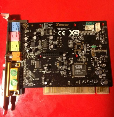

First post, by Fusion
Seems to me its an SB Live! clone. I couldn't find much online but it seems to be ok?
http://www.techexcess.net/ProductInfo.aspx?pr … ctid=LWHA571-T2

Reply 1 of 5, by gdjacobs
It's an ESS Allegro chipset, so it's ESS' PCI sound technology. Although it doesn't provide true ESFM like a Solo-1 does, Iit should use the same sideband technologies and therefore be quite compatible with DOS -- much more so than a SB PCI/Live card.

Reply 3 of 5, by Fusion
Oh nice, I heard from somewhere that ESS chips were great for DOS.
I guess the question might be, is this better then my SB Live Value?

Reply 4 of 5, by gdjacobs
For DOS, absolutely superior.
Reply 5 of 5, by Fusion
Awesome. How does it compare to a ISA SB16? The mobo has the SB-Link (?) jumper on it.
