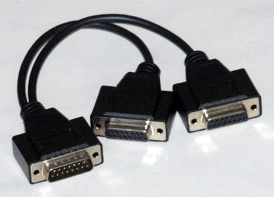

I have a question to our vogons member dreamblaster.
Is it possible to connect the 'CHiLL and Phil Adapter' (onboard with a S1/S2/X1/X2) to a gameport Y-cable, to connect also a Joystick + the adapter at the same time?

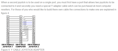

I think this will work,
you'd need to connect the chill n phil pcb to joystick 1 output
and your joystick to joystick 2, if this pinout is correct.
https://allpinouts.org/pinouts/connectors/inp … ck-pc-gameport/
26.48 KiB
371 views
you can measure on your Y adapter :
the Chill n Phil Adapter uses pins 4, 8 and 12
so if these are passed through, it should work.
