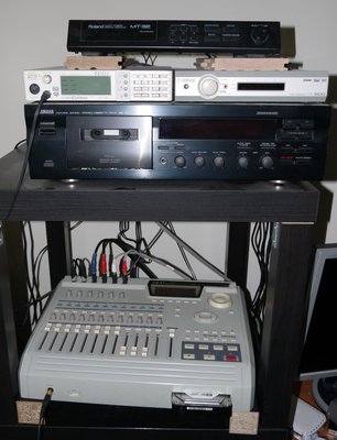

- MIDIMAN MIDISport 2x4 running in passive mode and with output 2 looped into input 2 (turning it into 1x3 midi splitter) connected to AWE32 via DB15 to MIDI cable
- first generation Roland MT32
- Roland SC-88VL
- Yamaha MU500
- Akai DPS12 multi-track recorder used as an audio mixer
- RCA brand 4x1 component AV switcher (not enough inputs on the DPS12)

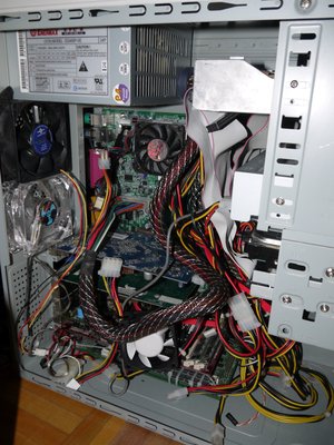

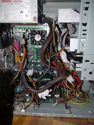

923.61 KiB
1172 views
2.93 MiB
1172 views
3.14 MiB
1172 views

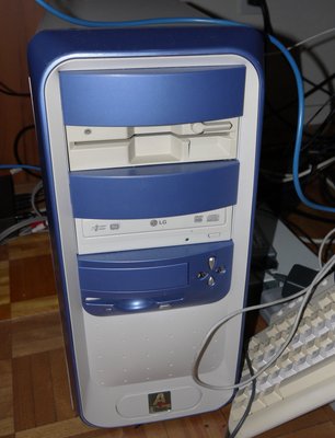

The tie wraps around the SB32 are a homemade fix for the broken SIMM sockets . It works surprisingly well .
2.2 MiB
1172 views
Reply 3 of 7, by Tetrium
Good to hear about the ISA bridge chip not being much of a problem for you. I never tried a bridged ISA slot myself, so can't say that much about it.
Your build seems well thought out and looks to be solidly build and with solid parts at first glance. Nice!
And don't worry about the (lack of) cable management, it's mostly not really relevant once the system is working. I mainly tie cables together to prevent cables from jamming any fans and by the looks of it, you have plenty airflow 😀
I'm not sure about your graphics card (might be on the new side for pure DOS), but the main thing is that it works 😁
