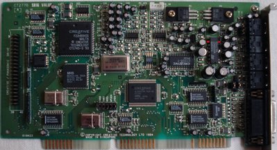

I have been setting up old computers recently for a number of different applications. You guys have been the most helpful resource I have found on old hardware - thank you!
I have an old Sound Blaster 16 value (CT2770) card which works but barely. I want it to use the OPL3 chip and am programming this directly in linux without any drivers. My program works fine on other cards, so this is a HW sound card issue.
The issue is that the volume on one channel (left) is rather low and the volume on the other channel (right) is almost but not quite zero. Anyone have any idea what is causing this and how it can be fixed?
Could it be that one channel is dead and all I am hearing on it is crosstalk? But that wouldn't explain why the other channel is a bit too quiet too.
Or is it that one or more of the caps have gone? There is no visible physical damage to any of them. There are a *lot* of caps to be thinking of a re-cap without any expectation of success.
thanks for your help!
Richard

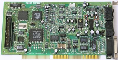

I had the exact same problem on a SBPro2 card and I managed fix it.
I played a 440Hz signal using MPXPlayer in DOS and used a DVM to probe for AC voltage from the Output all the way back to CT1336A on a live card, but I already knew where to probe.
The Input Cap right before the amplifier was dead (discontinuity) and did not pass the signal, but everything before it was the same for both channels.
This problem is quite common with Creative old ISA SB cards for some strange reason...

On your card the input pins to the amplifier should be marked in red (second from top on both sides), so find the caps that go to these pins and replace the correct one:

Reply 3 of 8, by rwkaye
Thanks ever so much James! I am impressed!
I changed those two caps.. both small 1uF caps on the input pins of the TEA2025. Things are now much better. One channel is producing the level I was expecting and really sounds fine. The other is definitely working (and independent of the first so it's not crosstalk I am hearing) and it's an improvement but still much quieter than needed. I am only using the OPL3 device and not very bothered about the rest btw.

Reply 4 of 8, by James-F
Post a photo of your mixer settings.
The L/R imbalance is only from the OPL3 part of the card or are PCM sounds (in games or windows player) also imbalanced?
BTW, are you using the Line-Out or Speaker out?
Also, are all the jumpers near the speaker output in place?
