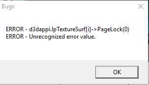

Hi, sorry if I speak badly, use google translator.
The game does not allow high resolutions, and dgvoodoo by an error in the menu.
  How can I fix it?

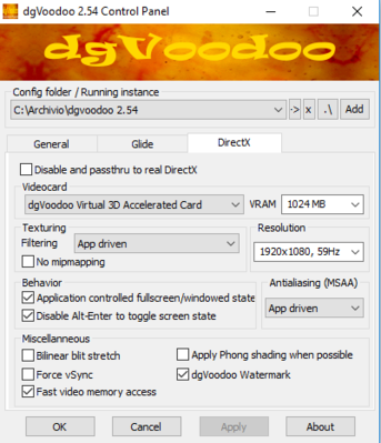

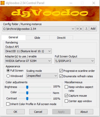

Which version of dgVoodoo are you using?
I tried this game with dgV 2.54 and it works.
It's true that it only works with default CPL settings, with 'Unspecified' scaling mode. So, upscaling the resolution and such won't work because this game doesn't like when its window get resized, etc.

I needed dgvoodoo to increase the resolution, because 640x480 looks bad.
These are the settings.
