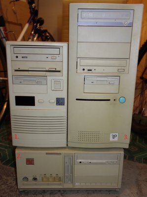

Hello everyone. Recently I've rescued three old PCs, got them for free. I discovered this great forum, so I decided to reminiscence good old times and have some fun with these older computers. I will try to log my all three builds (upgrades more or less) here, hope it won't get messy.
Unfortunatelly I sold/dumped most of my older hardware during moving to new place five years ago. Still I've some spares left. But I don't want to build PCs that I had back then, I'd rather search for parts I didn't have due to costs or just because I had other platforms. Another goal is to buy old components as cheap as possible, I was shocked, when I realised how expensive are parts that few years back nobody wanted for free.
220.66 KiB
3839 views
1. Socket7 i430VX build
When I first spotted I was happy that I'll get myself an 486 PC. But it is only sticker on an old case which was upgraded. But never mind, it is interesting for me anyways.

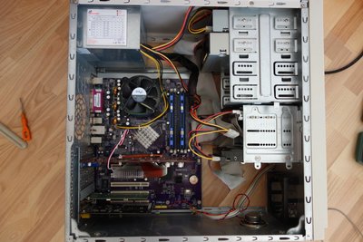

Although newest of the three computers, it wouldn't run. It was only beeping, replacing another RAM helped. But the mobo is somewhat picky on memory positions, one of my memory modules can't be in first slot alone (but works in second slot alone 😖). I ended up running 256MB DDR266 + 256MB DDR333 in dual channel happily overclocked DDR333. CMOS battery dead, OS drive dead. But the motherboard looks OK, no bulging or leaked capacitors.
Plans for upgrade:
Originally I wanted to trash this PC, but this devil machine influenced me somehow. Now I can't help myself reviving it. And because I've never had Pentium4 desktop and this board offers interesting combination of LGA775 (cheap CPUs and wide range of coolers opposite from going with socket478) and 865PE from AGP era, I'll keep it. Back at the time I had AMD CPUs (AthlonXP, Athlon64) and Radeon 9500 card unlocked to 9700 (great card); so I'd like to build fast P4 machine with GeForce FX just for fun 😀 Hyperthreading-enabled CPU would be fine, because it feels almost like dualcore 😊 . This would be a Win XP to play my older steam games on it, hopefully.

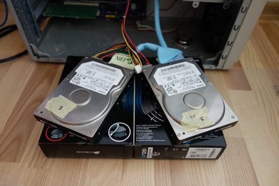

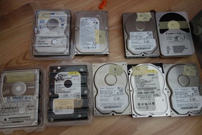

Replaced CMOS battery in the 775 motherboard and it is look like it's going to be OK. Now time to test and choose some OS drive for it. Looked into my drawer and find some 😊 The first two drives top left are sata, but unfortunatelly they are dead, or near death. The two top right IDE drives are not perfectly OK too. The bottom left drive is my original 20GB Maxtor 5400rpm drive I got from my uncle from an apple computer (it is still working) - remember the exact date, it was september eleven 2001....
Finally went with WD800BB. It's biggest, fastest and most quiet of all them

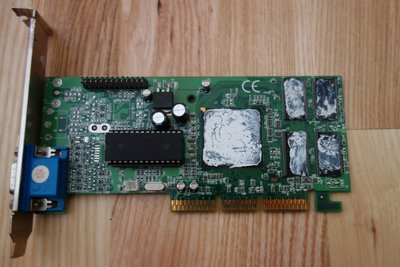

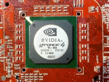

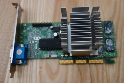

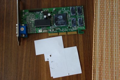

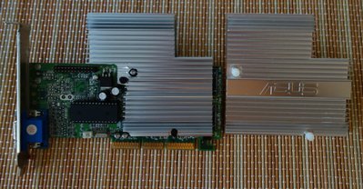

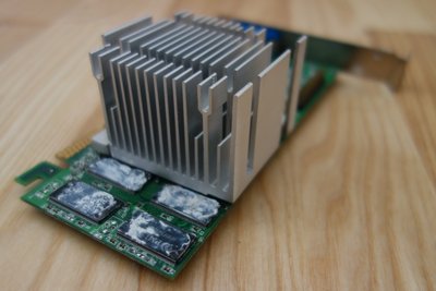

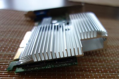

With the third computer finaly running I've purchased MSI GeForce4 TI 4800SE 128 DDR AGP card for about $6.6 with postage. More or less standard long PCB similar to Ti4400/4600 card with NV28 chip and BGA RAM chips. The original HSF was replaced for something that looks like Socket370/A CPU cooler. And was "secured" with copper wire, which caused wobbling on the chip.
To my horror after unmounting the cooler, there was no thermal paste. The chip looked like lapped, but I think that was caused by the aforementioned wobbling. Exactly like on the photo - the central part is silver, whereas the outer part has been rubbed (?) to copper.
Anyway time to fix it with my spare zalman 😎
So ready to stick it into the LGA775 build (god I hate the expansion card secure mechanism in this case... of course it barely fits)
And it is running 🙄 😁 at least in 2D mode.
Now installing WinXP and ton of updates.
Reply 3 of 31, by melbar
Well, there are nice parts you have got for free.
Interesting that the GF4 is not dead without thermal paste. You have to check it 2D & 3D.
I think it had to resist really high temperatures...
Originally it should look like this:

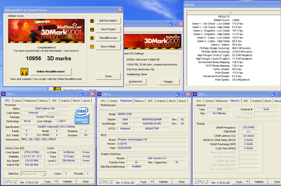

It looks like my GF4Ti survived 😎 although it seems that it develops some coil whine under the load. But the image is rendered correctly.
187.15 KiB
3739 views
3DMark2001SE score is 10956 which is nothing to write home about 🙁 I will have to do something with it, Celeron is holding it back it seems.
I digged my original 3DMark2001SE score from 2003 when I (on purpose of course) tried to break ten thousand points limit, with success:
RESULTS
3DMark Score 10022
Game 1 - Car Chase - Low Detail 139.3 fps
Game 1 - Car Chase - High Detail 60.5 fps
Game 2 - Dragothic - Low Detail 164.3 fps
Game 2 - Dragothic - High Detail 85.9 fps
Game 3 - Lobby - Low Detail 146.5 fps
Game 3 - Lobby - High Detail 70.6 fps
Game 4 - Nature 59.0 fps
This was done on good old GF3Ti500 (41.09 drivers) overclocked to 255MHz/560MHz and on KT400 board with AthlonXP 1700+ (thoroughbred) overclocked to 2 GHz (12x166 MHz) which is something like 2400+ but with faster FSB.
On the contrary I must admit the stability and compatibility of an intel platform. Clean WinXP installation found all of the devices but soundcard. Besides realtek audio drivers, I installed "full" nvidia drivers and nothing else. AGP runs on 8X with sideband enabled, fastwrites enabled, no problem at all. I still remember nightmares with AGP compatibility on various socket A boards, occassional lockups and tuning these parameters (usually turning of fastwrites helped) to make it work.

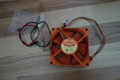

During the weekend I've also:
- disassembled and cleaned the case, unfortunately the plastics are yellowed but I do not plan to retrobright it - some stylish proper chieftec case would be better
- cleaned power supply (it was suprisingly in good shape and not very dusty)
- reassembled it back, rearanged cables a bit and got rid of unused parts 😊
- I've realised that my spare 400 watt power supply (also noname but newer) with 12cm fan has actually weaker all (5V, 3.3V and even 12V) rails than current Maxpower 350 watt PSU, even though it's clearly lighter and "half-depth" so I decided to keep it in the PC

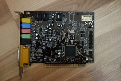

- installed SB Live! CT4830 card from my drawer (just for sake of it, will not make my integrated speakers inside old Acer LCD sound better, but it is a nice looking card and I like soundblaster)
- after closing the case, I realised, that the P4 generates a lot more heat compared to celeron, although it is rated for the same TDP and is only 200 MHz faster... have to be the cache. Remember how those ugly P4 cases had windtunnel for this particular reason (and we, athlon owners, were laughing at them 😊 ). I do not plan (yet) to replace intel HSF with anything else, but I found my old stylish Thermaltake Smartfan from 2002. Now it is running at slowest rpm as case exhaust fan, but it is by no means silent according to nowadays standard (at maximum rpm it sounds like vacuum cleaner but produces huge amount of airflow). And its color nicely matches color of the AGP slot ...

Fill Rate (Multi-Texturing) 2320.3 MTexels/s
High Polygon Count (1 Light) 61.8 MTriangles/s
High Polygon Count (8 Lights) 12.6 MTriangles/s
Environment Bump Mapping 147.9 fps
DOT3 Bump Mapping 149.5 fps
Vertex Shader 99.3 fps
Pixel Shader 126.5 fps
Advanced Pixel Shader 88.8 fps
Point Sprites 31.3 MSprites/s
I also added to my 2x256 MB HyperX KHX3200 kit another two modules - two sticks of 1024MB "lowend" Kingstons DDR400 CL3, they had to be in the first and third slot in order to set proper SPD timings but even then, this board automatically sets CL2.5 (not CL3) for all of the modules and it's running fine. When I had HyperX modules first, I was getting occassional lock-ups although with the same timings as above.
I think I'm done upgrading CPU in this system, all in all the P4 is not that bad (nowadays), but still the AMD 64 3200+ clawhammer s754 setup I had in 2004 was better at that time, not only power or temperature wise. Only the sc754 boards were not that mature as intel ones (or it was due to integrated AMD IMC which was new to the market.... which resembles me the actual Ryzen memory realted issues 😊 ).
On the other hand with 2.5 GB RAM and hyperthreading enable I must admit that this P4 system is still quite usable today for normal tasks, such as internet browsing with the actual Firefox ESR; it behaves almost like a dual core system.

Today I decided to upgrade Virge/DX with more capable card but from my limited card collection (GF4Ti 4800SE being too powerful, TNT2 M64 is weak and the other cards are PCI, but I will need all three PCI slot for additional LAN, audio, IDE cards) I found old noname Geforce 2MX 400 being most appropriate. Unfortunately it was (again) equipped with CPU heatsink which takes up another three or four expansion slots.
311.78 KiB
2950 views
295.57 KiB
2950 views
It had also ramsinks glued with mixture of superglue and cooling paste but previous owner took them off, so I removed the GPU heatsink and cleaned it all the way I could. I've noticed, that ram chips are actually 5ns which is good for a noname card, so overclocking VRAM to 200 MHz should be no problem.

In my stockpile of coolers I only had one-slot heatsinks from ASUS (7600GS?) passive cards, so I had to cut it, drill hole for capacitor and make frankenstein cooler 😈
406.2 KiB
2950 views
Reply 16 of 31, by mv_cz

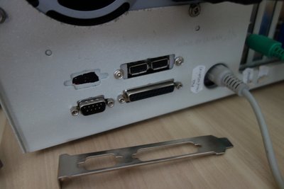

It takes up some space above the video card, but it is no problem, I've rearanged COM and LPT brackets, moved the ports away into prepared holes in the case under the AT power supply to make some room for the card and also put the USB ports in there.

Video card is up and running fine, finally I can run GLQuake (71 fps in 640x480x16bpp bottlenecked by the CPU, but higher resolutions throw an windows error 🙁 ). Heatsink is warm to touch, which is ok, I didn't expect MX400 to be hot, since passive variants vere common.

I've managed to succesfuly rewire PS/2 header in order to use mouse in my socket 7 build. Unfortunatelly user manual doesn't list pin assigment for PS/2 and USB headers. So the right PS/2 mouse header pinout for PcPartner (Vtech) MB520NH board is:
5 - Clock
4 - GND
3 - Data
2 - not connected
1 - +5 VDC
Where pin number 5 is the top pin, closest to the edge of the motherboard.
