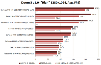

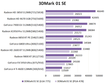

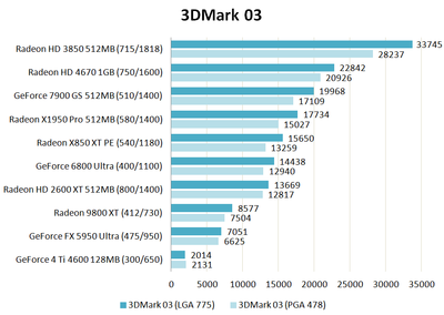

x1950 Pro will be better in everything.
Here are some PGA 478 numbers for you :

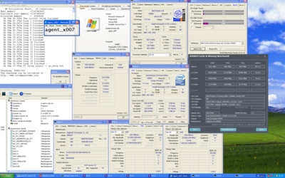

No 7600 GS, but 7900 GS should do the trick I think (it's 20PS/7VS version btw.) 😀
Oh, and PGA 478 numbers are done on Pentium 4 EE 3,2GHz @ 3,53GHz :
738.76 KiB
1553 views
While LGA 775 ones were done on highly OC'ed Pentium Dual-Core E5800.
And yes, those are AGP ONLY.
