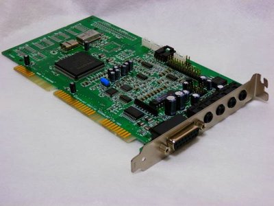

These are the cards I got:
CT2950

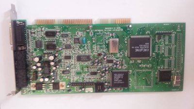

CT2940

Reply 3 of 9, by firage
Yeah, forwarding that stuff from over there is going to double the price pretty quickly. They're really not worth a fortune, yet anyway.
I can't quite read the mixer chip, but looks like one of the newer revisions that also went on early AWE64's. The DAC related chip there is more important to SNR, but that's a given by 1995 as they were already up to this final version on any board they put out. Should be good sound quality as the final configuration before Vibra chipsets. (And then that CT2940 is the very best example of a Vibra SB16.) Still has the bugs that SB16/AWE32's have, but sort of an interesting item.
Installing and configuring sound cards and CD drives is always a little bit more involved than in Windows, but nothing too special happening here. A DOS/Win 3.1x installation package is still available on Creative's website, "Sound Blaster 16/SB32/AWE32 Basic Disk for DOS/Windows 3.1 Installation" filename sbbasic.exe. Direct URL's are a little silly with their web platform, but Google will get you there. The CT2940 is PnP, but it doesn't even require initialization once it's been set up, which is pretty neat.
